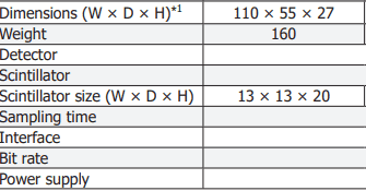

Thank you very much for the information you provide.These are detector information.I added the data I received and the excel file I prepared for comparison.These are the data I get when I put the source(60 Co) 5 cm away.This source source activity 87357.2 becquerel

The scintillator is 13mm x 13mm x 20mm ?
What shape is it?
Is the scintillator modeled inside MCBEND? If so how, ie what exactly is being counted?
Actually I first asked this question for MCNP and cylindrical NaI(Tl) detector. However, I lost the usb with some of these data and I need to repeat some experiments. These are my old data. This detector is rectangular prism and the data is for MCBEND.I runned this code for 50000000 particle history so I tried to multiplied count values and 50000000.I sent right graph and MCBEND code.The scintillator shape is rectangular prism.
