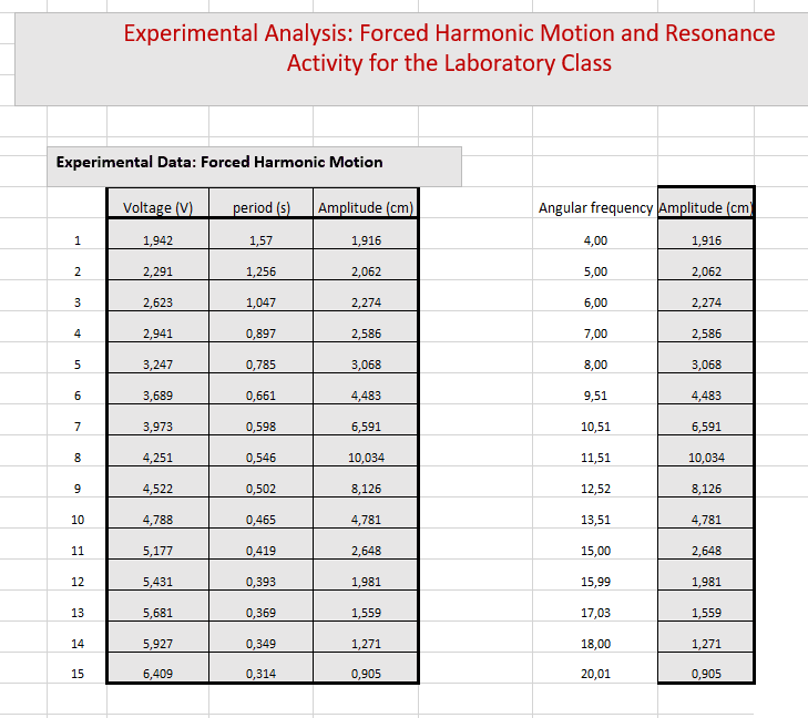

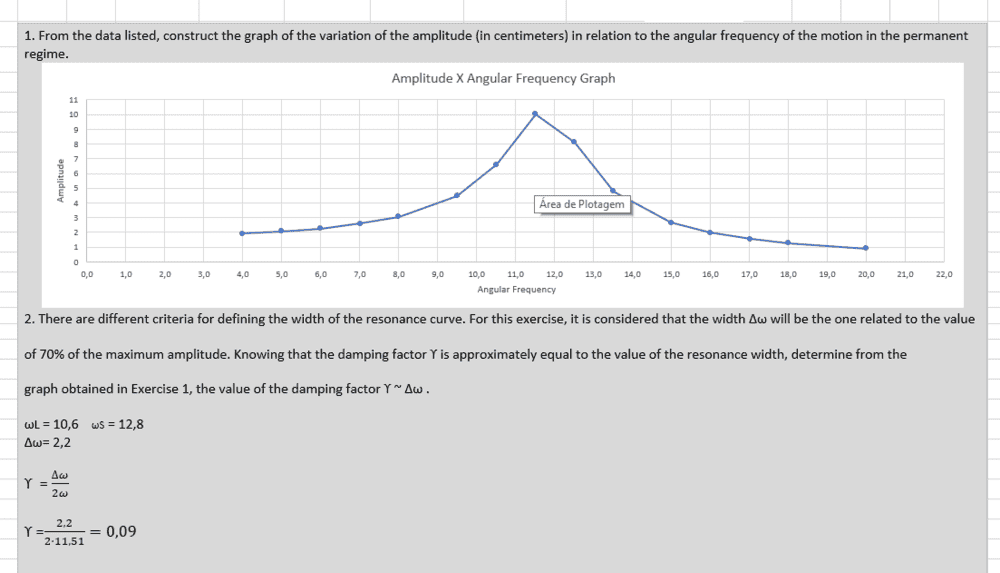

Regarding the exercise itself, I need help mainly with questions 3 and 4 that I sent in the original format (excel), as I am not sure if the file will work I am sending images too.
The exercise is based on an experiment consisting of a spring-mass system connected to a motor, the goal is to gradually increase the rotation of the motor until the spring enters resonance while amplitude and time data are collected.
