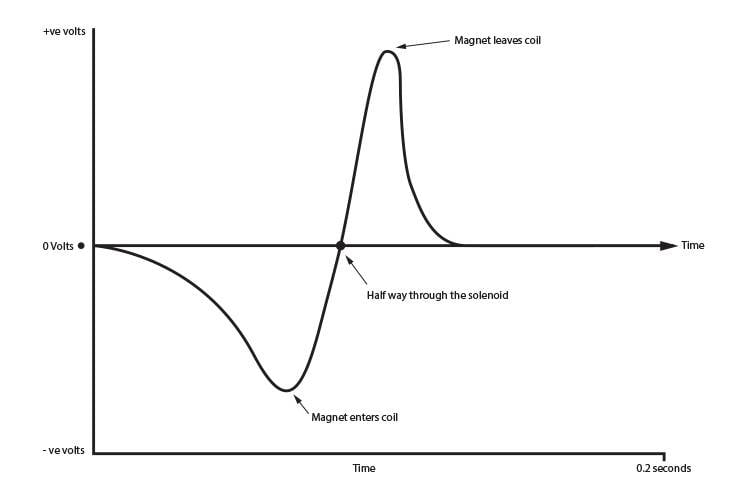

Does increasing the velocity of a magnet moving through a solenoid increase the EMF detected by a voltage sensor?
\varepsilon=-N \frac{\Delta \Phi}{\Delta t}
Looking at how the induced EMF is proportional to the rate of change of magnetic flux, intuitively it seems that if I increase the velocity of the magnet through the solenoid, i.e. drop it from a higher height, the EMF should increase as well. However, I am unsure if this is true and can't seem to find a derivation to check this. I want to make sure before I submit this to my lab technician as a practical to do.

Thanks a lot!
- I have attached a photo of a graph showing the change in voltage over time. You can see that the current reverses as the magnet passes through the halfway point and ∴ the velocity also reverses. However, I am simply looking at the magnitude of the Voltage, so what is really relevant for me is the y-coords of the maximum points. Theoretically, if the velocity increases the magnitude should also increase, but the area under the curve will remain the same as the "pulse" becomes shorter to account for cons. of energy.
- I was planning on using either a galvanometer or a voltage sensor linked up to a scope to show the changing emf.
Good. You will note the negative and positive parts of your graph have different sizes/shapes. Can you explain that? (And at the same time answer your question (Post#1) about the relationship between induced emf and velocity?)
Edit. Comment deleted! There are 2 emf maxima - one is positive and one is negative. Do they have the same values? Which one do you want!?
Maybe (or maybe not) the areas are the same but I don't see what conservation of energy has to do with it.
If you are planning on dropping a magnet through a coil, are you certain the response-time of a galvanameter would be adequate? Maybe you could estimate a ball-park value of the required response time using some assumptions and simple kinematics.
A conventional 'scope would briefly give a waveform similar to your graph, but would then vanish! You need a storage scope or maybe a data-logger to get a decent emf measurement.
So some careful thought about the experimental design and equipment limitations is needed.
But first, make sure you first have a clear obective for your investigation. You should know what your are trying to do - e.g. test some specific quantitative hypothesis.
Likes BvU, billyt_ and Charles Link

Note: Since EMF ## \mathcal{E}=-d \Phi/dt ##, and the flux reaches a maximum as the voltage or EMF goes to zero, (i.e. ## \mathcal{E}=- d \Phi /dt=0 ## at the maximum ## \Phi ##), and then the flux decreases again to zero as the magnet moves far away from the ring, by looking at ##| \int \mathcal{E} \, dt | =|\Delta \Phi | ## for these two regions, they do indeed have equal areas.
Edit: Note that the area under either region of the curve of voltage vs. time allows for a simple measurement of the flux ## \Phi ## across the center (interior cross section) of the magnet. If the loop of wire is much larger than the magnet, the reading will not be accurate, as the flux looping around outside the magnet will make the reading (area under the curve) lower than the actual value of the flux across the interior cross section of the magnet.
