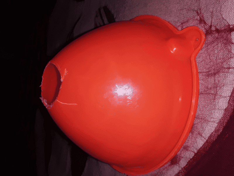

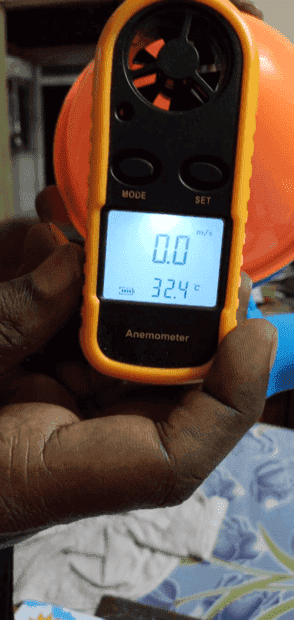

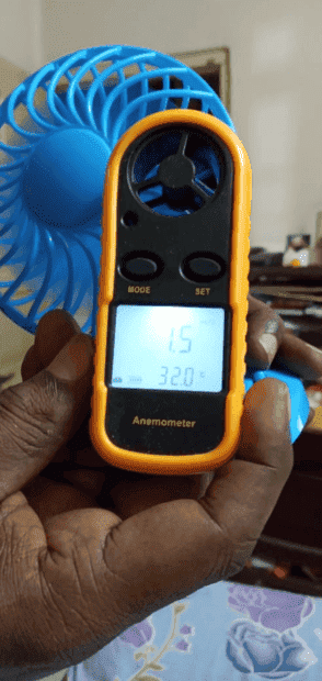

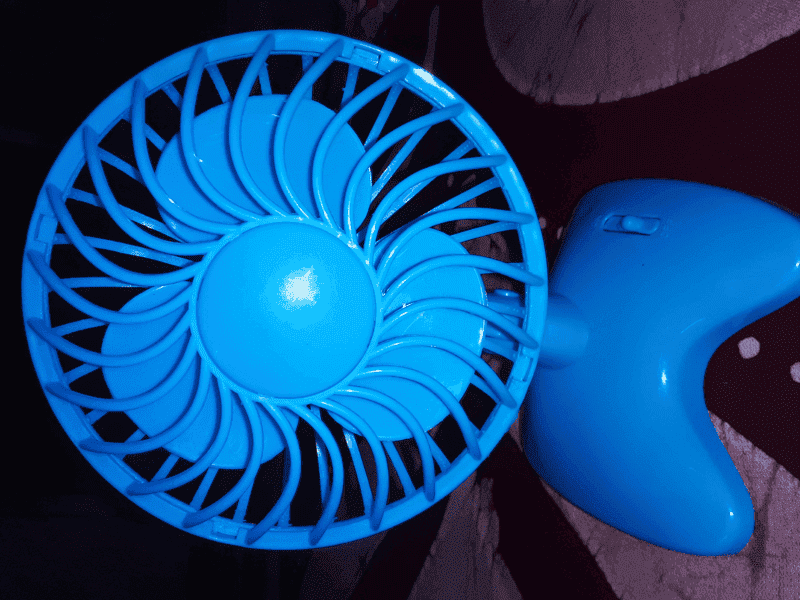

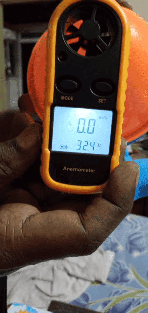

Actually the problem started with my home made experiments. I have a small fan and I set a home made nozzle before it. But, every time I measure the velocity of flow from and fan and the velocity of the flow coming out of the throat, the velocity at the throat found to be less than the velocity at the entry. The anemometer can measure velocity upto 30 m/s and the velocity of flow coming from the fan is 1.9 m/s and the inlet to throat ratio of the nozzle is roughly 5:1. I want to know the reason.
Well, that's something we can help with. Please provide the details of the setup, including a dimensioned diagram and make and model of the fan, and a description of where and how you made the measurements.
Also, as far as I can tell, your issue here has nothing to do with the Venturi effect. You are asking about the area/velocity relationship, which is a mathematical proof/law, as a consequence of continuity for incompressible fluids. It has to be true. The Venturi effect has to do with the pressure change, which you didn't measure.
It's the fan having 8 cm diameter blades.
It's the nozzle. 11 cm diameter at the inlet and 2.5 cm at the exit.
And you can see that when the nozzle is fitted, the reading at the anemometer has been shown to zero.
And, by the way, the pressure only decreases when the velocity increases. Does the pressure decrease when the velocity wouldn't increase accordingly?
That's a 19:1 area ratio, not 5:1.
That's not how this works. Continuity means that you are taking measurements on the same system at different places in the system (along a streamline). Here, you've measured two different systems:
  • System 1: A bare fan. (measuring its airflow)
  • System 2: A fan with a nozzle attached. (measuring its outlet airflow).
This is a common error people make when analyzing such systems.

Also, to answer what the real question/issue is here: what you've learned is that your fan is too weak to push a measurable amount of airflow through your nozzle. It can't generate the necessary static pressure.
The flow is subsonic, and it should accelerate inside the nozzle. Whatever may be the static pressure. That's the theory correct. And what minimum static pressure is needed to push the air through the nozzle?
T C said:
Actually, I have considered the diameter of the fan as the inlet, not the original inlet area. To calculate the ratio, you have to consider the fan diameter, not the entry of the nozzle.
Then that would be 10:1, but the mismatch in fan and nozzle inlet diameters can do nothing but cause problems. It leaves room for air to spill out around the blade tips. At that point, the true inlet diameter becomes very poorly defined. This will no doubt add error to an area/velocity ratio measurement.
Yes, and surely it does. But you didn't measure the velocity change - and your anemometer apparently isn't capable of measuring such low velocities anyway.
What's the reason that the anemometer can measure velocity without nozzle, but not the velocity with nozzle.
I answered that already:
Can you give me some idea about how much static pressure is necessary to get the desired results?

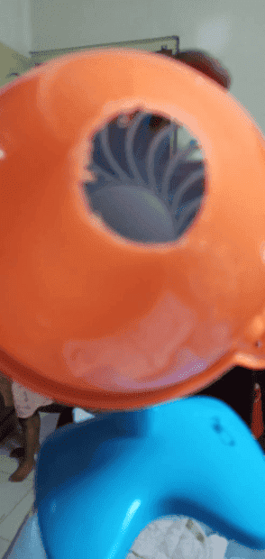

Your setup is very flimsy, the velocity at the inflow of the nozzle is blocked because the air would rather spill along the sides of the nozzle, than accelerate through it (which requires static pressure as @russ_watters already pointed out). The smaller the outlet area, the more air is spilled along the sides. You assume that the inflow velocity into the nozzle is equal to the free stream velocity of the fan, which is far from true.
Likes hutchphd and russ_watters
Thanks for your reply. Can you tell me how to prevent the spilling of air?
You need an enclosed system with a proper fan in front, you'll need to build static pressure. The fan you use is not made for building static pressure. The fan needs to be enclosed in the system at the tips as well, and the blade need a different shape (flat at the tips) such that you have no flow leakage.
You also cannot change the setup as you do measurements. So you need to find a non-intrusive way to measure the flow velocity into and out of the nozzle. The flow velocity you measure needs to be related to the average velocity of the flow at that position, and you need to calibrate for that.
In fact, you need something like a wind tunnel. Doing real accurate measurements is hard...
Make the fan diameter be just slightly smaller than the inlet.

The gap. The gap is too big. Reduce the gap. You have to reduce the gap.

T C said:
At present, my biggest problem is to reduce the spilling over of the flow to the minimal and measure the inlet and exit flow after that. Just that and nothing else.
Not really, no. The inappropriate fan and low minimum velocity of the anemometer are big issues too. Other than simply measuring the area/velocity relationship you haven't specified a goal, and any/all of these issues will prevent you from measuring the area/velocity relationship.
  • #47
jack action said:
You must have two anemometers: one in front of your fan - with the convergent nozzle over it - and another one at the outlet of your convergent nozzle.
You can use the same anemometer in two different places as long as you don't change the system in between. I was going to suggest on the inlet of the fan. I know that's not as reliable as the outlet, but it would be something. But that doesn't even matter since the fan is stalled and the velocity is lower than the anemometer is capable of measuring. As far as I can tell, the current setup can't be cleaned-up to make it work. He needs to start over from scratch with a bigger fan at least.
  • #48
Likes Vanadium 50 and russ_watters
  • #49
That anemometer is large enough (as a fraction of the duct size) that it almost certainly appreciably changes the flow.
  • #50
Agreed. And it could be increasing or decreasing the velocity depending where the fan is on the curve. One of the reasons I suggested a bigger fan is both the anemometer size issue and the gap/re-circulation issue are decreased just by getting a physically larger fan/system (assuming same gap size in cm).
