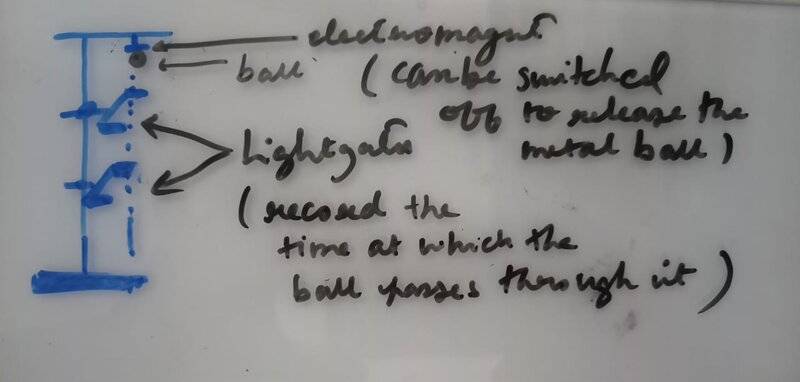

TL;DR Summary: I need help with determining the value of 'g' using the data I have collected in the lab, using an apparatus consisting of light gates fixated on a stand, the positions of which can be varied.
I have attached what my apparatus looked like, and my analysis. A metal ball is held at an height by an electromagnet. Turning off the electromagnet releases the ball, which passes through the light gates positioned at d1 and d2 respectively. When the ball passes a light gate, it records the time at which it passes.

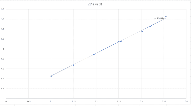

My values of instantaneous accelerations are coming out just fine. The part where I am facing trouble is when trying to determine it from the slopes of the graphs of velocity vs time, or position vs time squares, or the square of velocity vs position.
for instance, the slope of the graph of v1^2 vs d1 (attached) is coming out to be 4.5654. Comparing this with the kinematic equation v^2 = 2gh, 2g = 4.5654, which means g = 4.5654/2, which is not even remotely close to the accepted value of g. Where am I going wrong?

That's the average velocity, not the instantaneous velocity which is what appears in ##v=\sqrt{2gd}.## I suggest that you follow my recommendation in post #4.
Likes scottdave
Then what yo call v1 is the average velocity over the distance d1 and not the instantaneous velocity at the position of the first gate. If you use ##v1^2=2ad_1##, ##v_1## should be the velocity after travelling the distance d1 and not the average.

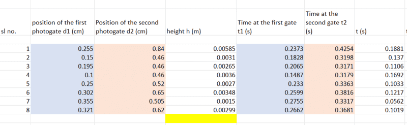

As I read the data table and the drawing, you are adopting a downward = positive coordinate system with the origin at the electromagnet.
##d_1## is the position of the top gate (in cm)
##d_2## is the position of the bottom gate (in cm)
##h## is the difference: ##d_2 - d_1## (converted to meters)
##t_1## is the time at the first gate (in seconds as per the column heading)
##t_2## is the time at the second gate (in seconds as per the column heading).
##t## is ##t_2 - t_1##
We are not told whether the time coordinates are accurate relative to a drop time at ##t_0 = 0## or are if the drop time is only approximately zero.
We can attempt some rudimentary analysis to confirm the interpretation of the columns.
First line: 0.2373 seconds for a drop of 0.255 cm. In 0.2373 seconds at 9.8 meters/second squared we should have managed ##\frac{1}{2}at^2## = 27 centimeters of drop.
No. That is unrealistic. But suppose that ##d_1## is actually expressed in meters. 27 centimeters is close to 25.5 centimeters. So let us proceed on this assumption.
First line: 0.4254 seconds for a drop of 0.84 meters. ##\frac{1}{2}at^2## = 0.89 meters. That is a reasonable match as well.
Which means that the "height" column is also off by a factor of 100.
It looks like our time readings quoted to four places are good to something a bit less than 2 significant digits. The zero point on the readings may be off. This may be a random error. Or it may be a systematic error.
Second line: We have 0.1828 seconds for a drop of 15 centimeters. ##\frac{1}{2}at^2## = 16.3 cm.
Predicted distances seem to be about 6 to 8% high. So the measured times must be 3 or 4% low. We could look at the remaining lines to see how consistent the error is. But let us cut to the chase.
Conclusion: We cannot assume that the time of the drop is zero.
No matter. We are after a formula that can take the elapsed time between the ball passing two measured displacements and calculate an acceleration from that.
