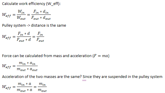

WORK EFFICIENCY
I could say that the loss might be due to friction in

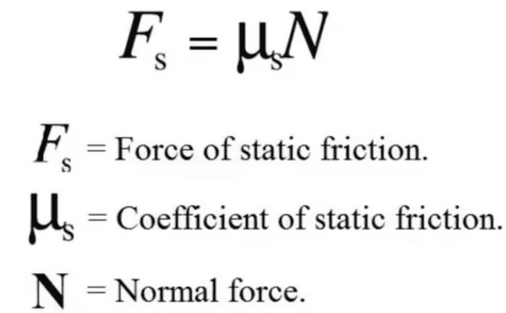

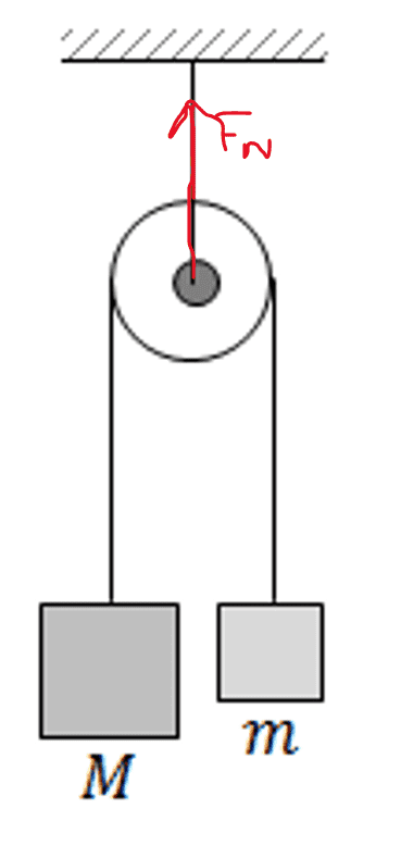

Can I apply this formula to this situation?
I guess the normal force (F_N on my drawing) in this situation would be F_N=mg+Mg
But I guess this only applies to the friction between the rope and the pulley. I can't see how to calculate the friction between the axle and the pulley. But I guess I would have to look a torques rather than force.
