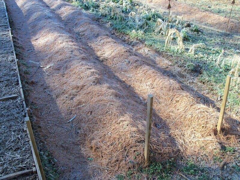

Explain how soil is not frozen after 3 weeks of below freezing weather.
It has been below freezing for 3 weeks, 12°F at night and in mid 20s during the day. Yard and garden are frozen 2" deep hard as cement everywhere except 3 row in the garden covered with 1/2" of pine needles. Soil under pine needle is not frozen I can push my finger into the soil 3" deep. How can 1/2" of pine needle keep soil from freezing?
Wood mulch is frozen hard as cement too.
This is winter potatoes. There should be 200 lbs of new potatoes about May 15 in these 2 rows. Potato rows with no pine needles soil is frozen 2" deep.

Only water becomes solid at 32°F, the rest of the soil already being solid. The only explanation I can think of is the lack of humidity under the pine needles.
If the pine needles were fresh cut then possibly there is a small amount of very slow decay that produces just enough heat to keep things from freezing. Unlikely but possible.
Likes sophiecentaur
The insulation effect is created by the volume of trapped air, as well as the number of little pockets of it.
Regular mulch can't compete with that.
Besides, the leaves themselves, even when dry, may keep some of their anti-freeze properties.
Please, see:
https://www.earthdate.org/node/139
Likes sophiecentaur, 256bits and Baluncore

Add to that the fact that direct radiation loss from the soil to the sky has been eliminated.

2 inches of pine needles seem to be good for at the very least 3 weeks period, if not longer, of 12 F air temperatures as expressed in the OP.

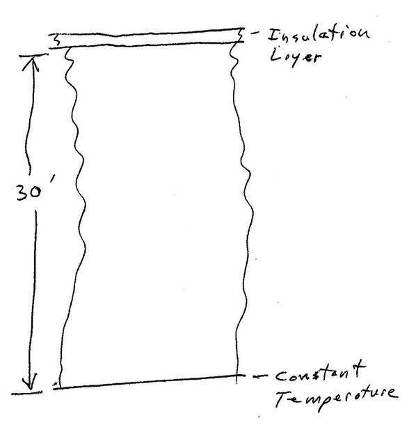

Back to the OP... We can look at this as a 1D heat transfer problem. Soil temperature is constant at 30 feet down and below. Between the surface and 30 feet down, it varies seasonally, with additional daily variation in the top few inches. Good search terms for more detail are soil temperature vs depth. The pine needles are an insulation layer, or more correctly, a layer with lower thermal conductivity. A simple, possibly oversimplified, diagram:
The temperature 30 feet down is a constant 40 degrees F in my Northern Wisconsin USA climate. The temperature between that level and the surface will be warmer than that at the end of summer. Since the temperature gradient is warmer toward the surface, there will be heat flow upward. The rate of heat flow is a function of the temperature gradient in degrees F per foot, and the thermal conductivity of the soil.
Next, an insulation layer (pine needles) is added. The temperature drops. Now there is heat loss upward through the insulation layer, and the rate of heat loss is a function of the temperature gradient in degrees F per foot, and the thermal conductivity of the pine needle layer.
Next, the effect of thermal mass needs to be added to the above model. The thermal mass of soil is a function of the specific heat of dry soil, the density of the dry soil, and the moisture content of that soil. It will typically vary with depth.
At some point, the heat loss upward through the pine needles overcomes the heat flow upward through the soil, and the soil layer underneath the pine needles freezes.
A simple experiment would take two or more low cost digital inside/outside thermometers. Bury one probe under the pine needles, and the second probe a few inches down, then watch them for a few days or weeks.
