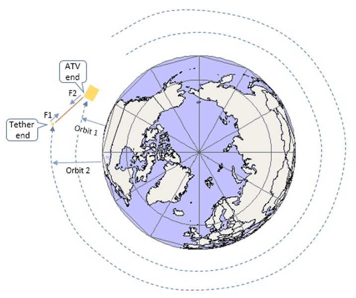

Lots of good information, but I'm still stuck on the orbital mechanics side, so I put together a picture. The picture shows Orbit 1 of the ATV and notional Orbit 2 of the "end point of the tether". ATV Orbit 1 is lower altitude and faster orbital period. Tether End Orbit 2 is higher altitude and slower orbital period. So after an equal time period (as shown in the picture), the ATV in Orbit 1 is "ahead" of the Tether End in Orbit 2. And since the ATV wants to continue to go faster, but is tied to the Tether End, it will actually exert a force, F1, on the Tether End. Conversely, the Tether End in Orbit 2 does not want to go as fast as the ATV and so it will exert a force, F2, on the ATV. This is in addition to the previously discussed EMF forces. I'm suspecting that the orbital forces will be take a couple hours to be felt - tether must fully extend, etc. If the ATV-Tether was a rigid body, then center of mass and moment of inertia could apply, but they are not rigid at all. So my guess is that over time, the forces F1 and F2 would act the same as orbital attitude jets and would force the ATV and Tether End into a single orbital plane with the lower orbit, larger mass ATV being in the front and with the tether trailing behind. The final orbit, Orbit 3, would be very minimally higher than the original ATV Orbit 1.
The orbital period is faster for an object in a free orbit. The satellite is not in a free orbit. You cannot use equations that assume no external forces (apart from gravity) to study a system where two things are connected by a tether.
No. the forces involved will pull the tethers so that they point away from and towards the Earth. This is known as gravity-gradient stabilization or tidal stabilization.

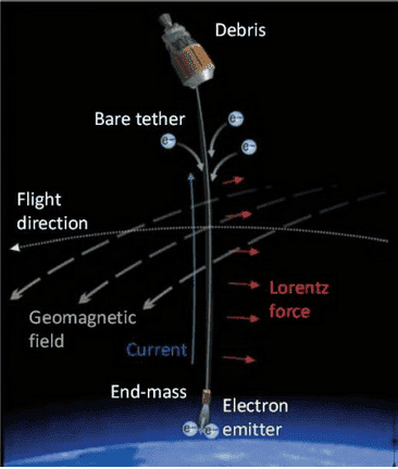

Thanks 1oldman2... yes, sorry to hear that the JAXA effort failed.. Well, they now take their place with a number of others who have not succeeded. I get it that "space is hard", but seeing what NASA and other nation's space agencies have accomplished, it's hard believe that the "tether" problem could not be solved after more than a decade of attempts. It speaks more to me that something is not well enough understood?
The graphic is quite interesting... I can see Fleming's Right Hand Rule at play and the direction of the current, but the position of the Electron Emitter is puzzling? And then the electrons entering at the top?
Likes 1oldman2
I sort of assumed that the tether has to have insulation along most of its length. The "electron emitter" will be producing positive charges at the same rate as electrons, once equilibrium is reached.
