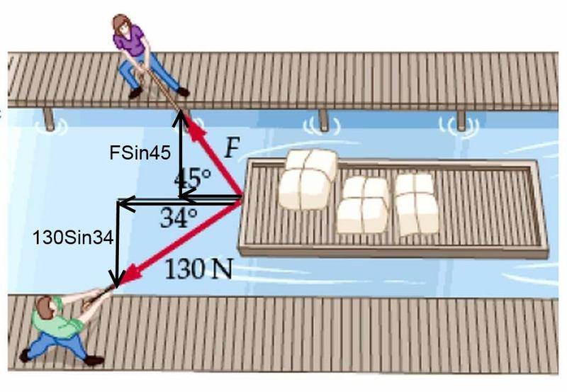

I think a diagram would save time.
agentlee said:
http://www.csun.edu/~phys100a/solutions_cadavid/hw4-ch5.pdf
I found the problem here #28. I just don't understand why you would use sin and not cos. My professor said that whichever the angle is being made with, you would use cos with that axis.
If you wanted to calculate the net force in the forward (X) direction you would use cos, but that's not what you're after here. What you need is for the Y components of the two forces to cancel, so the angle of interest in each case is to the Y axis.
The diagram clarifies the problem. It confirms it's just a 2D problem not a 3D.
I have split the vectors into two components which might help. Remember that..
Sin(∠) = Opposite / Hypotenuse
so
Opposite = Hypotenuse * Sin(∠)
