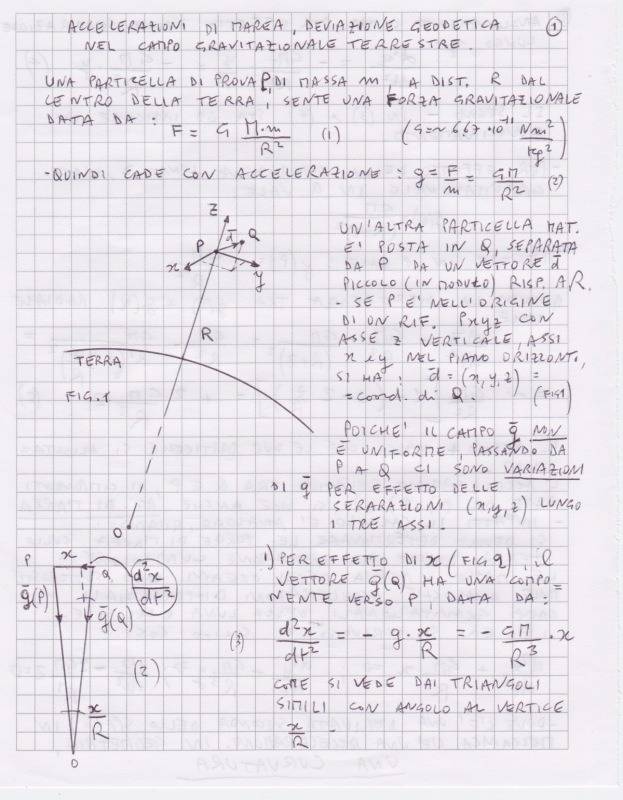

It is possible to quantify the effects of tidal accelerations, due to non-uniformity of the gravitational field around a spherical body like the Earth, just using the Newtonian law for universal gravitation. Have a look at the two sheets at the end: they are written in Italian, but I think are not difficult to understand. Physics is made of concepts written in the language of mathematics, and formulae need not be translated. I wrote these pages many years ago, for an article to be published.
But for the sake of clarity I will clarify some terms :
The title is simply : “ Tidal accelerations, geodesic deviation in the Earth gravitational field”
Free explanation , not literally translated:
There are two material particles , P and Q, separated by a small vector ##\vec d##, the distance of P from the center of the Earth is R . Let us assume a local reference frame (P,x,y,z) , with z vertical , x and y in the horizontal plane. As the field ##vec g## is not uniform , there are variations passing from P to Q , that is in all three directions (x,y,z).
The separation x (fig 2) causes a component of ##\vec g(Q)## toward P , because the two vertical directions from P and Q converge towards the center O of the Earth; we have equation (3) :
## \frac{d^2x}{dt^2} = -g \frac{x}{R} = - \frac{ {GM}}{R^3} x ##
the same applies to y, equation (4) :
## \frac{d^2y}{dt^2} = -g \frac{y}{R} = - \frac{ {GM}}{R^3} y ##
The “-“ sign means that the particles are approaching each other in the horizontal plane.

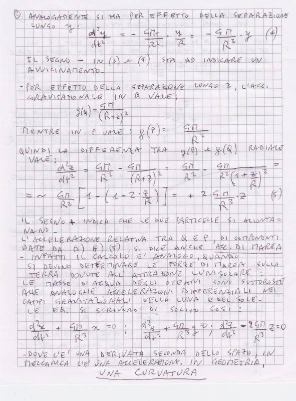

As for the separation along the z axis , taking into account that when the distance from the Earth’s center becomes (R+z) the magnitude of g decreases , because :
## g(R+z) = \frac{{GM}}{(R+z)^2} ##
there is a difference between the radial components of g(P) and g(Q) , which can be expressed ( see (5) for details) as :
## \frac{d^2z}{dt^2} =+ 2 \frac{ {GM}}{R^3} z ##
the “+” sign means that the two particles will increase their distance in the vertical direction.
These ones are called tidal accelerations, because the calculus is analog to that carried out when you have to consider Earth tides, due to the Moon ( and the Sun too).
Thank you for the attention.
Only to a good approximation, for the case of weak fields and velocities small compared to the speed of light. Outside that regime, the Newtonian approximation breaks down.
Yes, of course. That’s why I have clearly stated at the beginning that I’m concerned with Earth, not with a neutron star or a black hole, where one has to use the full GR equations, and determine the 20 components of the Riemann curvature tensor.
I remember that the gravitational potential around the Earth , compared to ##c^2## , is of the order of ##10^{-9} ##, while for the Sun it is of the ##10^{-6}##.
