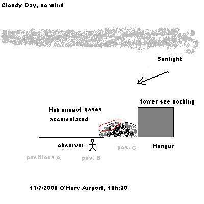

Jet planes have HOT invisible exhaust gases.
In other cases just find the heat source (ex. a long queue of cars).
Geometric configuration on the environment makes those hot gases trapped
in some sort of bubble with a more or less defined surface.

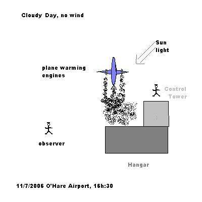

A jet plane was near the event scene warming engines as a preparation to taxi away, and finally it goes away.
The no wind condition prevents the quick spreading of gases.
Turbulence became reduced and a bubble is formed with a more or less defined surface.
The delimiting surface between the hot region and the colder environment is reflective to tangential rays and gives the grey colour that makes people think they are seeing a metallic object, with stealth properties. It can only be seen from some directions and became opaque preventing the vision of background buildings and other known pre-existent features.
Hot air goes up and it reveals the 'UFO' hovering the airport.
Mutatis mutandis for other scenarios.

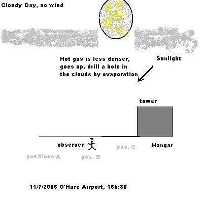

Finally the hole in the clouds became explained. Yes, you have guessed. Hot gases have evaporated the little drops of water in the clouds by releasing the heat.
In the sketches the bubble is dark colour for obvious reasons. In fact the bubble is transparent.

With this first post I’ have uploaded 3 simple sketches (jpg) to illustrate the geometry of the problem. I know that they are very simple, but I have no time to spend in the beautifying.
They became marked to approval. I think that the post will be better with them.

uploading the 3 drawings

Ok, now I have some serious problems with the physics.
You claim this 'ball' of hot gas is contained by some sort of 'geometrical' phenomena, please elaborate. Any gas in the atmosphere will mix with any other gas to obtain a uniform concentration. That's why farts don't stick around forever (thankfully). This is called diffusion, and the rate at which they mix is proportional to the temperature, exponentially so infact.
Wind is not needed for a ball of hot gas to disperse, it does that by itself with the random thermal motions of the atoms/molecules. A temperature gradient in the atmosphere will cause a change in refractive index yes, but referring to my previous post, several United Airlines pilots reported seeing an 'object' out of the ordinary at O'Hare. These guys are seeing jet exhaust every day, and I'm assuming this wasn't the first calm day in the airports' history.
Of course hot gasses will cause optical effects, but you're proposal is lacking in physics and fails to explain why this hot gas was somehow magically contained in three dimensions with a well defined boundary.
Based on the upward velocity of the hot air stream, the rate of effusion of the hot air, and the altitude of the clouds, it seems that one could estimate the size of the hole in the clouds that we would expect, if any. Perhaps there is an existing model that could be used.

Are there any pics of the heat-light-reffraction that can show me what it looks like?
I will illustrate with an example from common experience:
You are driving a car in a very hot day, and your son (5 years old) is at your side.
(for safety send him to the back seat after this experiment).
He is looking to the road far ahead and exclaimed: Look, the road is wetted, is it raining there?
No son, it is not water. You are just seeing the sky reflected in the hot air.
Pa, it looks like water!
As you are an adult you are not expecting to see the water in the road, so you know that it is not. You don’t believe.
Your sun knows nothing about light bending and optical effects. He can only see water. He believes.
The internal representation of what we see must conform to experience.
In this experiment 'water' is an object.
In the O'Hara event the 'object' is also the sky reflected in the hot air.
But the ‘object water' colour is different from the one seen in this ‘object’!
Yea, there is no black asphalt in the sky.
heldervelez, I have been in contact with someone who is not only a real expert on some of this, but who also likely knows all of the reported details of the O'Hare event. For the moment he wishes to only relay his thoughts for your consideration. I will add a few comments of my own as well. If anyone objects to this, I guess we could have Greg [the owner of PF] verify that the related personal email does exist as represented here.
The first issue mentioned gets back to the rate of effusion. He seems to indicate that we might expect more a bubble, than a column of rising air. But his position on this was not entirely clear to me. Based just on my personal experience, particularly with campfires, I would tend to expect a column of air that effuses much less quickly than it rises. So, my own expectation would be that of a rising and expanding, approximately conical volume of heated air. But, again, without having done a formal analysis, I can only suggest that this is what we might expect.
The next consideration was that we might expect this cloud-hole phenomenon to be fairly common around airports. That being the case, we might expect this to be well understood already. So I think the objection amounts to one of “where’s the evidence?” Why don’t we see this on a regular basis?
To me it seems possible that we may be talking about something that occurs only under specific conditions. As a result, it may rare, and when it does happen, it may often go unnoticed.
The next point may be a bit more difficult to counter. The alleged object was seen to hover at a fixed altitude for a couple of minutes.
If the details of the event are known to this level of precision, then your explanation would seem to be in direct contradiction to the reported observations. My suggestion would be to determine the confidence that we might have in the reports of “hovering”. Perhaps this part of the story is not well supported, in which case we might allow for this. If on the other hand this directly contradicts the alleged facts, then it becomes more troublesome.
The next two considerations are that of the angle through which the light is refracted, and the claim of a silvery disk. The objection made is that we would only expect refraction through an angle of less than one degree. So while we might select preferred positions of observations to coincide with your explanation, the facts of the case, as reported, do not agree with this. One witness was reportedly almost directly underneath the observed phenomenon. So in order for our explanation to work, we require more refraction that we would expect. Also, we have no reason to assume that the boundary layer between the hot and cool air would appear as a silvery or gray metal disk. While I do understand your expectations here and would tend to make the same assumption, we don’t know this to be true.
Also, we don't really know how quickly a hole would form in the clouds above. Would this happen in a flash, or would it take place over a period of several minutes, or more? I don't think we can say without just guessing.
The final point was that while you have the top of the bubble rising faster as it gains altitude, we might also expect it to slow as the temperature of the hot and cold gases approaches equilibrium. So, again, we need a rigorous model to make the correct determination here.

I read Heldervelez' illustration of what the effect he supposes explains the sighting. He illustrates the atmospheric refraction by the well known inferior mirage effect: light from the sky that travels downward at a very small slant angle compared to a flat road, is bent upward very slightly and so, instead of hitting the road and being absorbed, this light travels upward at a very slight angle. If a person happens to be looking along the road and if the person's eyes are not far above the road (a few meters or less, depenging upon the distance to the horizon), the person will see this upward-traveling light which, because it is light from the sky, is brighter than the light reflected from the road. Hence the person will see "skylight in the road."
This occurs when the road is hotter than the air that is a meter or so above the road. The road surface heats the air that is immediately above it, causing an atmospheric temperature gradient, dT/dZ, that is negative (the temperature drops as the altitude increases). The air somewhat above the road is cooler and therefore more dense than the air next to the road. The speed of light is lower in cooler, denser air. The phenomenon of refraction or bending of light occurs when a light ray encounters a gradient in the speed of light, alternately known as the gradient in the magnitude of the refractive index, n = c/v, where c = speed of light in a vacuum and v = speed of light in a medium, in this case, air. Since v varies with height (v decreases with increasing altitude above the road), n varies with height, being larger far above the road than at the level of the road.
Stated simply, light is "bent into" a medium of higher refractive index (in this case, cooler air) from a medium of lower refractive index (warmer air). The variation in refractive index is a very small quantity in air. Hence a light ray has to travel within the gradient region for a considerable distance in order to achieve noticeable bending. In the case of "Water on the road", the "water" generally appears to be hundreds of meters in front of the observer, and this requires light to pass through many meters of the air near the road. The density gradient is not perfectly uniform over the road because convection causes some air to rise and cooler air to fall at various locations along the road. This causes the refractive effect to vary with time and one sees "wavy" skylight above the road.
A similar effect occurs in the vicinity of flames or other sources of very hot air such as hot air that comes out of a jet. If one is looking along the column of heated air the effect of "waviness" on light rays coming from objects beyond the heated volume can be quite noticeable. (I'm sure that virtually everyone knows this from experience.)
In this particular UFO sighting, the requirement that the light pass through many meters of air that has a refractive gradient, and the consequence of the very small refractive gradient, namely that the total bend angle be very small, MIGHT be satisfied for the observer directly below the "object" if the observer were standing in a location very close to the bottom of the assumed cylindrical column of heated air. Looking upward along the heated cylinder boundary the observer might see something like the "water in the road" effect, except that in this case the observer would see light from the cloud cover at 1900 ft. The observer might see a "wavy" cloud effect. However, there is no reason to believe that the "wavy cloud" image would appear as an object, darker than the clouds, that hovers at a constant height for many seconds, even as long as a couple of minutes (exact duration not known) and then suddenly accelerates upward and appears to rapidly punch a hole in the clouds.
The observer directly below would have the greatest chance of seeing something unusual because the light rays travelin downward from the cloud cover would have traveled along the longest possible path distance, namely, along the length of the supposed cylinder of heat. However, for observers at considerable distances from the supposed heated cylinder, the distance traveled within the temperature gradient region would be much smaller. It is likely that they would see no more than the slight "wavy" effect one sees when the sighting line to distant objects passes close to a flame. There is no reason to believe that this slight wavy effect would appear as a solid object, blocking the light from directly behind it.

As I've pointed out it must begin with a thermodynamical CFD model , and it is premature an optical expert opinion, as we don’t have enough data to characterize the optical part of the problem.
The airport is like a furnace and the burners warm up the air at different altitudes in the ascendant/descendent trajectory above lanes.
quote http://www.ufocasebook.com/2007/narcapcase18.pdf (pag. 24 of narcap case18 report from Dr. Haynes et al.)
O'Hare's air traffic controllers typically handle about ninety six arrivals per hour or one every 38 seconds, usually on multiple runways. They are kept extremely busy.
end-quote
being 1 arrival each 38s, it will be 1 airplane (arrival and departure) each 19s;
what is the thermal transfer to the atmosphere in the combustion of jet fuel in Taxiing (T minutes), and in the landing phase (Ls seconds), and in take-off (Ts seconds) ?
Each plane as at least 2 engines and a mean value for the power delivered by each one must be obtained due to the different type of engines in presence.
take-off lanes
quote http://www.ufocasebook.com/2007/narcapcase18.pdf (appendix F.4, pag. 148 of narcap case18 report from Dr. Haynes et al.)
F.4 Personal Observations as a Pilot Related to Take-offs on Runway 32L and 27L at O'Hare Airport on
November 7, 2006 at About 4:30 pm.
It would appear to me that if there was any change to runways due to the UAP's presence it would have most probably been departures on runways 27L and specifically 32L. An aircraft sitting on the "button" of runway 32L would have had a clear view of something hovering over gate C17 almost
regardless of the UAP's altitude. An aircraft departing on either of these runways would get increasingly closer to the object as they climbed out. An aircraft on 32L would have been looking up at the bottom of it from a distance of only approximately 1,500 feet laterally to the east. An aircraft taking off on 27L would have been at a greater altitude when passing the alleged UAP's position.
end-quote
Consulting the airport diagram at pag.12 it can be seen the gate C17 (UAP location) in in the 'center' of the airport and lanes 27L and 32L are just nearby C17.
can someone more versed in the facts and this text, enlighten me what are the lanes used in fact for the takeoffs and if I can presume that in lane 27L the takeoff is from E to W, and at lane 32L is from SE to NW ?
Can this configuration of takeoffs contribute to the increase of the 'curling' of exhaust gases?
can we expect that someone in this forum with thermodynamic expertise can do the CFD model?

The bubble is a direct result of a Rayleigh–Taylor instability
this is an effect expectable when a denser fluid (cold air) is on top of a less denser one (hot air).
do it at home experiment in this American Physical Society site:
http://www.physicscentral.com/explore/pictures/cup.cfm
http://en.wikipedia.org/wiki/Rayleigh–Taylor_instability
"movies" http://hmf.enseeiht.fr/travaux/CD0001/travaux/optmfn/hi/01pa/hyb72/rt/rt.htm
