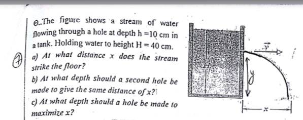

In summary: What force is there to accelerate it horizontally?There is only gravity, so the force is just gravity.

See the photo of the problem in the attachment
Bernoulli equation and continuity equation
I don't know from where to begin , i only can get the velocity of fluid when it reaches the hole

You must have been taught something on the topic. Any standard equations relating to fluid flow?

You should have listed those under Relevant Equations in the template.
So try applying Bernoulli's. What do you get?

Only the velocity of fluid at the hole , i don't know what to do i don't know any other information of how to get the distance x that the fluid will cover

That's a good start. (Next time, please show how far you got in your initial post, otherwise you risk having your post deleted.)
If you throw an object horizontally at a known speed and known height, can you figure out where it will land?

I think it's by laws of motion !

Yes, specifically, motion under constant acceleration. What equations do you know for that?

D=Vot+1/2at^2

Right. How can you apply that here?

That the problem I've faced , i don't know how to apply it here

What facts do you know in this problem regarding speeds, time, distances and accelerations?

I only know the distance from the hole to ground y is 30 cm and the velocity of fluid when it reaches the hole , i only don't know the time when it reaches ground and the acceleration of fluid .

What is causing it to accelerate, once it has left the tank?

Only gravity i think

Right, so you know the vertical and horizontal (0) accelerations.
Apply your equation for both directions.

So i can get the time from the y-direction equation and put it in the x-direction equation so i can get the distance x , is that right ?!

Right!

But why you assumed that the horizontal acceleration = 0 , if i didn't know that it equals 0 i can't solve it , so i need to understand why it equals 0
