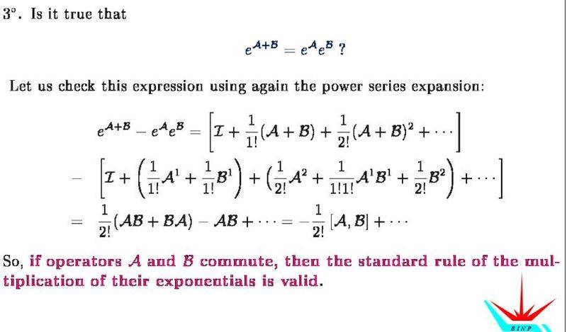

Can someone please explain the below proof in more detail?
The part in particular which is confusing me is
Thanks in advance!

What don't you understand? That seemed pretty straightforward. Do you know about power series expansions?
The idea is this:
We want to show that ##e^{A+B} = e^{A}e^{B}##. If they are, then we can say that the difference, ##e^{A+B} - e^{A}e^{B} = 0##. To demonstrate this, we use a power series expansion.
The power series for our exponential function is ##e^{A} = \frac{1}{0!}I + \frac{1}{1!}A + \frac{1}{2!}A^2 + \cdots##, implying that ##e^{A}e^{B} = \left(\frac{1}{0!}I + \frac{1}{1!}A + \frac{1}{2!}A^2 + \cdots\right)\left(\frac{1}{0!}I + \frac{1}{1!}B + \frac{1}{2!}B^2 + \cdots\right)##. Matrix multiplication is distributive over addition. In the proof, they shorten it for the benefit of saving space, so they don't show the step between the distributing and the grouping of the terms.
Is that fairly clear for you?
Oh ok! So they show the first two terms and "FOIL" it out for simplicity sake. I've been staring at this thing for 20 minutes and can't believe I didn't realize that.
That was a great explanation, thanks!
Could you also explain the 1/2!(AB+BA) portion in the last line?

Well, the technical term is "distribute," but yes. Sometimes math is silly like that, though, so I wouldn't be too irritated that you didn't see it.

(A+B)^2=A^2+AB+BA+B^2
Which if A and B commute can be written
(A+B)^2=A^2+2AB+B^2
In general we cannot assume this so we either include the terms for each ordering ie
BAA,ABA,AAB
or we include one ordering and appropriate commutators
[A,B]=AB-BA

I get 7 terms from [tex]e^{a+b}[/tex] but 9 terms from [tex]e^ae^b[/tex] after I distribute and I don't see a way to cancel them all?
You need to expand ##e^{S+T}## further. For instance, a term in ##S^2 T^2## appears only when expanding ##(S+T)^4##.
Won't you end up with differing coefficients even with further expansion?
such as [tex]\frac{1}{4}S^2T^2 - \frac{1}{2}S^2T^2[/tex]
You forgot a factor of ##1/2!## in the last term you wrote for ##e^S e^T##:
\frac{1}{2!} S^2 \times \frac{1}{2!} T^2 = \frac{1}{4} S^2T^2
