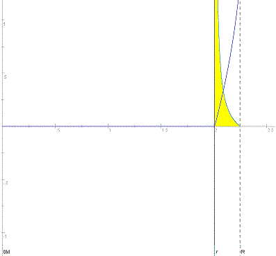

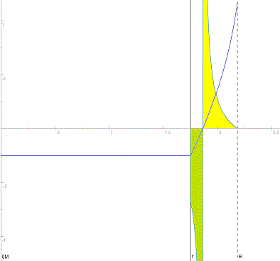

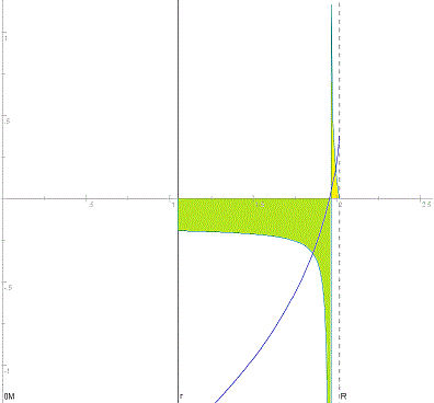

At first the equations seemed to show changes in the pressure of the vacuum in the cavity and I was wondering if the vacuum can have a pressure of anything other than zero in the extreme conditions inside a black hole possibly as a result of vacuum energy manifesting itself or simple as a result of gravitational energy density. Does anyone have any references on this aspect? Obviously a vacuum with anything other than absolute zero pressure goes against common expectations so for now I will assume the pressure in the cavity vacuum is zero and assume the pressure equations are not valid in that region.
I have done some graphs showing the pressure profiles of the shell material as it collapses. The horizontal axis in the diagrams is the spatial axis extending from 0M on left to just over 2.5M on the right. The filled curve represents pressure in the shell material and the blue curve represents proper time rate relative to coordinate time. The dashed vertical line to the right represents the outer radius of the shell (R) and the solid black vertical line to the left of the yellow shaded region represents the inner radius (r) of the shell material. Everything to the left of that is the vacuum cavity. The yellow area represents a region of positive pressure.
In this first diagram the outer shell is at 2.25M and the pressure at inner surface has become infinite and and a absolute horizon (time singularity) has also formed there, despite the fact that the inner shell surface is still outside r=2M. This is basically Buchdahl's theorem that predicts that a pressure singularity (and time singularity) will form somewhere inside a spherical object no matter what the mass distribution or equation of state is inside the the object, when the outer surface is at 2.25M. At this point there is nothing that can prevent the shell collapsing further.
In the second diagram, after further collapse, it can be seen that a "pressure discontinuity" has formed inside the shell material with a surface that changes instantaneously from plus infinite pressure to minus pressure. The negative pressure is represented by the green shaded area. The negative pressure regions also have proper time running in the reverse direction to coordinate time. Since a positive pressure at the inner surface boundary requires that the inner surface should move inwards, a negative pressure suggests the inner surface should move outwards. Negative pressure also implies a negative force of gravity. For the sake of argument let's say these effects are insufficient to overcome the positive gravity of the outer shell material and the shell continues to collapse further.
In the final diagram the inner and outer surfaces have moved further inwards but as result in the change of mass distribution the pressure discontinuity moves rapidly towards the outer surface. As a result the negative pressure of the bulk of the shell material dominates the positive pressure of the outer skin of the shell which is vanishing and there is suggestion that this may cause a rebound of the shell outwards. Another result of the pressure singularity is that there is never a point when the inner shell surface is at zero pressure so that surface can never reach equilibrium and it raises the intriguing possibility that the shell would oscillate with a characteristic frequency that is a function of its mass. Could there be any connection between such an oscillation frequency and the characteristic thermodynamic temperature of a black hole?
Of course I recognise that the equations I have used are for static geometries with uniform mass density and the sequence I have described is very dynamic. I am hoping that the tensor experts on this forum may be able to come up with some answers for a similar thought experiment with more realistic parameters. Possibly such an analysis would require a finite element simulation on a university computer, but the spherical symmetry should ease that task.
The equation is determined by the gravitational potentials M/R and M_r/r with uniform density only. If you take away all of the mass within radius r, the gravity drops to zero within the cavity, but the gravitational potential does not, so you can no longer use just M_r/r = 0, but must apply something else, based upon the gravitational potential that still exists from the mass above r. The equation only stands as it is with uniform density, so if one is to vary that density by creating a cavity, then M/R and M_r/r must vary according to the gravitational potentials that still apply, producing an entirely different equation.
