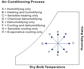

Take a look at this:
https://hvac-eng.com/psychrometric-processes/
