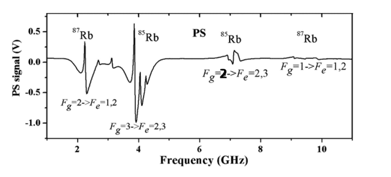

Recently i am doing an experiments about electromagnetic induced transparency in 85rubidum gas.

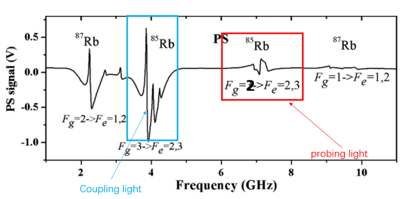

I have two light source,which use the polarization spectrom frequncy stablizaiton technology to make them stable.One is used for probing light,and the other one is used for coupling light.I will show you the polarization spectrom of rubidium85 below.and this picture is from[1].In this picture,the coupling light is stabilized in Fg=3 -- Fe=2(in blue),and the probing light is scanned in Fg=2--Fe=2,3(in red) with triangular wave.

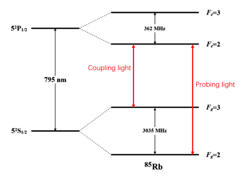

As you can see,I try to built an EIT configuration of Lambda-type.I will show you the energy level diagram for the D1 line of 85Rb.and in this picture,I point out the coupling light and the probing light.

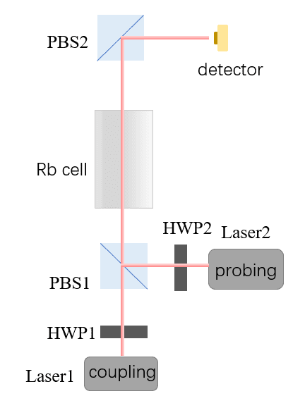

Also,I will show you my optical system below

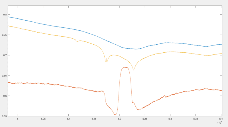

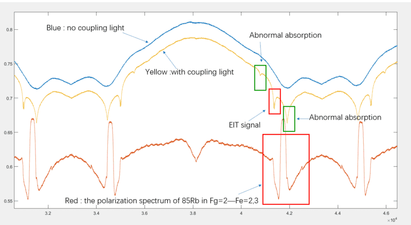

Then,I collect the signal from the detector in two situations.one situation is collecting the EIT signal with coupling light,and the other one is without coupling light.I notice that there are two strange absorption on both sides of EIT signal,and i don‘t know what it is.I will show you this signal below.

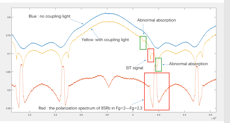

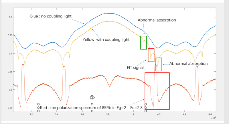

in this picture, the signal from detector without coupling light is in blue,and the signal with coupling light is in yellow.I also show the corresponding scanning polarization spectrom of 85Rb in Fg=2--Fe=2,3.
You can see from this picture,there are two abnormal absorption on both sides of EIT signal campared the signal without coupling light.can anybody tell me what it is?if you need any parameters like the width of these two signal,please don’t hesitate to contact me.or if you have some new thoughts about my experiment,please let me know.
