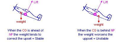

Xjazz said:
I assume you are preferring with center of lift a wing center of lift only.
I meant the center of lift for the entire aircraft. The first website you linked to above includes this picture:
The neutral point is the where the center of gravity needs to be located so that an aircraft has zero pitch stability (not positive or negative). The center of lift can be considered the vector sum of all aerodynamic forces on an aircraft. For a symmetrical airfoil (no pitching moment), they're effectively the same. If the airfoil is cambered, then they are slightly apart; the neutral point is further back for a wing with positive camber because of the pitch down aerodynamic torque.
You're diagram is a bit confusing because it appears to depict a symmetrical airfoil, no pitching moment (aerodynamic torque), and the center of lift for the entire aircraft and neutral point should be the same, so it appears you show the neutral point too far aft of where it should be. Without a pitching moment, then with the center of gravity and the tail's negative lift both being behind the center of lift for the main wing, the result should be a pitch up (clockwise) torque.

In practice the CG must be front of NP(lift), just like in your linked picture left side plane.
“For an aircraft to be stable in pitch, its CG must be forward of the Neutral Point NP by a safety factor called the Static Margin, which is a percentage of the MAC (Mean Aerodynamic Chord). Static Margin should be between 5% and 15% for a good stability.”
The professional pilots need to pay a lot of attention to ensure the CG location will stay within specification, while loading the plane with fuel, cargo & passengers.
The diagram is simplified in purpose, because the idea is to present how the tail force is countering the weight caused nose down moment. The use of symmetrical or asymmetrical airfoil won't change this concept.
