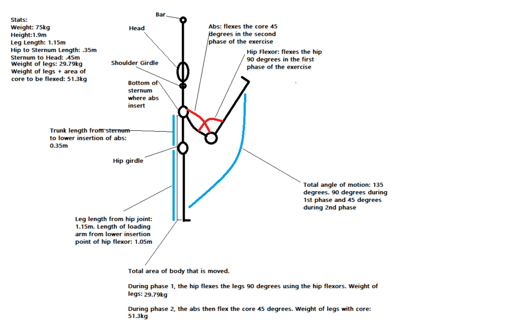

Athlete Stats:
Weight: 75kg
Height: 1.9kg
Leg Length: 1.15m
Length of Hip Girdle to Bottom of Sternum: 0.35m
Length of Sternum to top of Head: 0.45m
Weight of both legs together: 29.79kg
Weight of both legs and the weight of 66% of trunk: 51.3kg
The Hanging Leg Raise is divided into 2 phases. The 1st phase includes the hip flexors lifting the legs to 90 degrees so they are parallel with the floor. The spine should stay perpendicular with the ground. In phase 2, the abdominals then lift the pelvis complete with the already lifted legs and hip girdle to 45 degrees. Total degree of motion: 135 degrees.

To give folk an idea of what the goal is: it is to create a formula (via excel) by which we can calculate the amount of force produced/volume shifted by the abs and hip flexors during the hanging leg raise. Ideally I would like to have a formula which I can simply input someones stats and parameters of the exercise and get a returned value. Most exercises operate as close as possible to ones centre of gravity and utilise external weights.
E.g. a back squat of 80kg external weight for 5 reps over a duration of 15 seconds. Add in an extra say 30kg of upperbody weight which is also being lifted by the legs. You can quite confidently take 80kg+30kg, multiply by 5 = 550kg of volume and divide by 15 seconds = 36.6kg of volume shifted/force produced per second. Because the body is lined with its centre of gravity, the overall leverage/torque is 0 or negligible.
With bodyweight training however, you are using the bodys own weight and a lot of tension is created by levers. This makes calculating the actual amount of work done, a lot more difficult (at least for myself).
Appreciate any other perspectives. Have included an FBD and my adjusted excel formula for all to look at. Note, I have only created a formula for the first phase, not the second as I am still working on that.
  • Formula.xlsx
Your FBD is a good start. Now make all lengths to scale, muscles pull in straight lines except where wrapped around a bone, the pelvic bone needs to be a rigid link, the sternum is a horizontal distance from the spine, add distances from attach points to pivots, and add the center of gravity and mass of each link. Then simplify as much as possible.

You are on the right track. One way to tackle complex problems like this, and my preferred approach, is to start with a two dimensional model. In a two dimensional model, the hip joints are hinges, and the leg flexor muscles do not exist. The work is done by a simplified ab attached at a single point (in side view) at each end, and by a similarly simplified single quad muscle.
Does the pelvic bone rotate during this exercise? If so, it can be modeled with a hinge at the backbone. Keep it as simple as you can until you get answers, then add complexity to refine those answers. Continue until you run out of energy (likely) or have considered the effect of every muscle involved (not likely).
