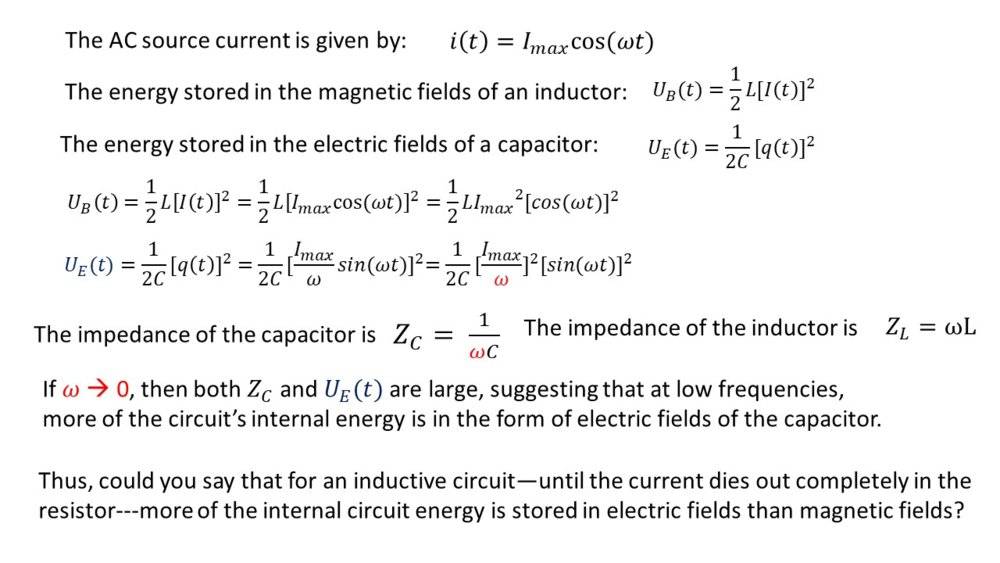

Hi all,
In an LRC AC series circuit, at which frequencies are where you are mainly dumping your generator/current energy into capacitor to create electric fields or into the inductor to create magnetic fields? So, for example, at low frequencies, f --> 0, the impedance of the inductor goes to 0 and the phase angle is +90 degrees, yet the impedance of the capacitor (1/wC) is ∞ . Is my circuit creating and destroying magnetic fields for the inductor, or is it creating and destroying electric fields in the capacitor? On the one hand, the inductor is acting like a short, but the capacitor is blocking all the current, so I'm not sure how to reason this out. I also need help for the same case for high freqs at phase angle -90 degrees. Which of these cases is called an "inductive circuit" and which case is a "capacitve circuit"?
Hi,
You are -- in the usual analysis cases -- not 'dumping' energy in L and C, only in R.
For precisely the 90##^\circ## reason in both L and C: ##\vec V(t)## and ##\vec i(t)## are perpendicular, so ##\vec V(t)\cdot\vec i(t) = 0##.
LC: video1 and video2
Yes, I understand that energy only actually leaves the circuit through the resistor.

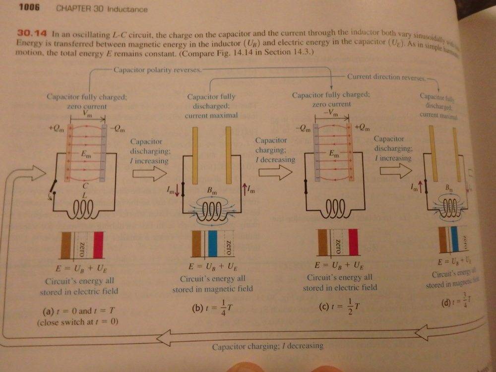

But, within the circuit, it takes energy to create magnetic fields for an inductor and electric fields in a capacitor. Depending on what time, t, of the cycle you are in, there are some magnetic fields that exist in the inductor and some electric fields between the capacitor. Both kinds of fields require some of the circuit's energy. I wrote the equations relating to this on the attached powerpoint.
I think I can rephrase this question better as: In an AC, LRC circuit, that is inductive (low freqs, phase angle +90 degrees), does this correlate to more of the circuit's internal energy being devoted to the electric fields of the capacitor rather than the magnetic fields of the inductor?
The other jpeg I attached is from a textbook of a slide of an LC circuit showing the energy transferred between magnetic and electric fields. I am trying to relate this energy transfer to the impedance or phase angle of an LRC circuit, if that is possible. Something like, as simple as "an inductive circuit stores internal circuit energy more in electric fields than in magnetic fields", but I realize that such a statement might not be as simple as I thought.
I did watch the videos you mentioned, but they didn't seem to answer my question.
I'm a bit confused by your question. Are you asking about the instantaneous energy storage on L and C? If so the answer is that the peak energy stored in each is the same value (this is neglecting R, for now). When the energy stored in one is at the peak, the energy stored in the other is zero. You can compare this to a pendulum shifting energy from kinetic to potential. This is also assuming we are talking about the natural response, not a driven response from a connected source.
edit: Sorry, I didn't answer your question. This resonant behavior doesn't depend on what the resonant frequency is. Just as the behavior of a pendulum doesn't depend on it's length. The numbers may change but the behavior doesn't.

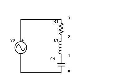

OK. First thing, forget about fields. There is no need to consider electric or magnetic fields to analyze a circuit.
Second, the key concept here is impedance. For a series RLC circuit, the impedance is:
##R+j2\pi{f}L-j\frac{1}{2\pi{f}C}## where ##f## is the frequency.
The tricky part if you don't have the math is ##j##. That implies a phase shift of 90 degrees.
If ##2\pi{f}L## is greater than ##\frac{1}{2\pi{f}C}## then the circuit is primarily inductive. If it is less, then the circuit is primarily capacitive.
Next consider the phase angle. If the circuit is series, then the same current passes through the R and the L and the C. Use this schematic.
The current I is ##I = \frac{V0}{R+j2\pi{f}L-j\frac{1}{2\pi{f}C}}##
The voltage measured between points 0 and 3 is V03. It is the same as V0.
The voltage measured between points 2 and 3 is V23. It is in phase with I.
The voltage measured between points 1 and 2 is V23. It is 90 degrees ahead the current I.
The voltage measured between points 0 and 1 is V23. It is 90 degrees behind the current I.
When averaged over an entire cycle, no matter what the frequency, the real power is all dissipated in R, and there will be zero net energy change in L or in C.

I see. I realize that what I was asking didn't quite make sense, I being a victim of my own misunderstanding. Yes, instantaneous values of energy on the components is what I am talking about here. What I thought is that; somehow, erroneously, the impedances could relate to the magnetic and electric fields stored in the inductor and capacitor; that is, I thought maybe that a large impedance on the capacitor at low function generator frequencies below resonance would indirectly mean that more internal energy of the circuit was somehow manifest in the electric fields of the capacitor. I realize this is not true, though, as mentioned above, the L and C together combine for total zero energy. The pendulum analogy above makes sense--I'd forgotten about that, but I'm glad Dave let me know about it.
I think I'm actually okay for now, and consider this question answered. @Dave, they were still good videos, actually, really good and I will use them later. So thanks for letting me know about them.

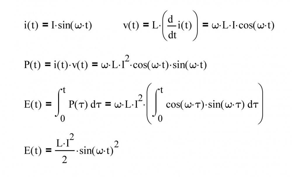

Make it simpler. Take an AC voltage source V and a L (no R no C). Write the equation for current I as a function of time, and power P=VI as a function of time. Then integrate power over an entire cycle and what is the answer?
You are getting confused by mixing AC and DC expressions.

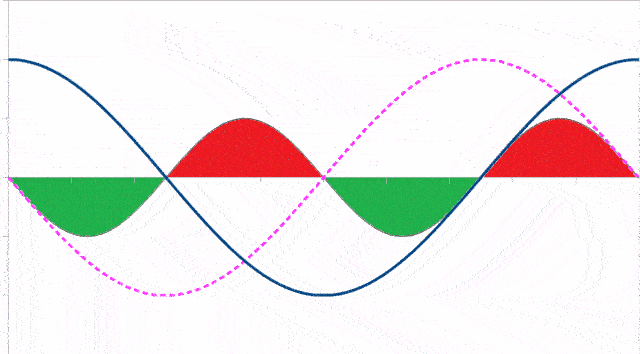

In particular, this plot showing V and I and P for the case where V and I are 90 degrees out of phase. In an RLC circuit, that should be applied separately to the voltage across the L and the voltage across the C. In both cases, we have that 90 degree shift.

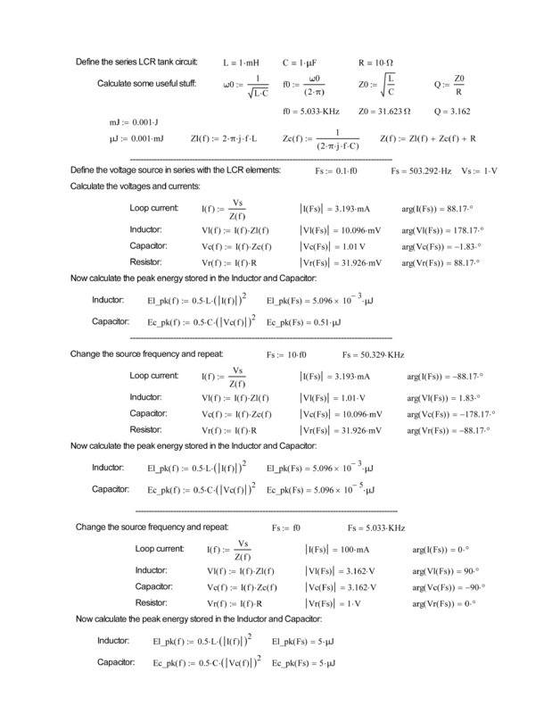

I've attached a calculation for an arbitrary Series LCR circuit driven by a sinewave. This is based on the phasor method and is only applicable for a single frequency source after any transients have died away.
Notice the difference between the values when the circuit is driven at resonance compared to away from the resonant frequency.

If I understood the OP correctly, he wants to know what it means when the net reactance of a series RLC circuit is capacitive or inductive in terms of energy stored in L and C.
It can be shown that
peak energy stored in L= (1/2)(XL/ω)(ipeak)2 and
peak energy stored in C= (1/2)(Xc/ω)(ipeak)2,
where ω is the angular frequency of the ac source.
So, at a given ω, if XL < Xc, the net reactance is capacitive and peak energy stored in C is more than that in L. This happens at frequencies lower than the resonant frequency.
For ω > ωresonant, XL > Xc and the net reactance is inductive. Here, the peak energy stored in L is more than that in C.

Yes, as Dave mentioned, the following is what I was after:
