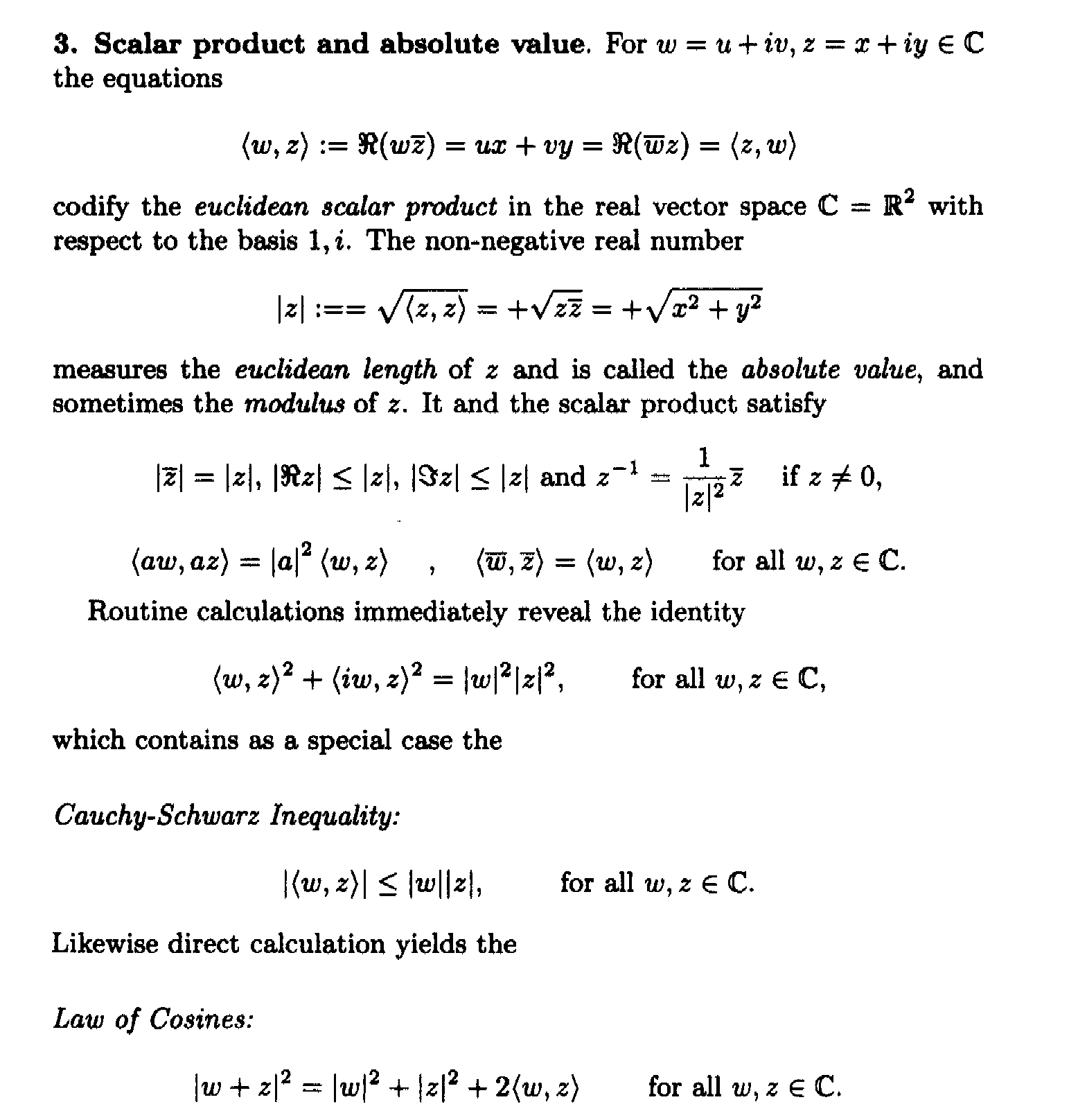

I am reading Reinhold Remmert's book "Theory of Complex Functions" ...
I am focused on Chapter 0: Complex Numbers and Continuous Functions ... and in particular on Section 1.3: Scalar Product and Absolute Value ... ...
I need help in order to fully understand Remmert's derivation of the Cauchy-Schwartz Inequality ...
The start of Remmert's section on Scalar Product and Absolute Value reads as follows:
In the above text by Remmert we read the following:
" ... ... Routine calculations immediately reveal the identity
\(\displaystyle \langle w, z \rangle^2 + \langle i w, z \rangle^2 = \mid w \mid^2 \mid z \mid^2\) for all \(\displaystyle w,z \in \mathbb{C} \)
which contains as a special case the
Cauchy-Schwarz Inequality
\(\displaystyle \mid \langle w, z \rangle \mid \le \mid w \mid \mid z \mid\) ... ...
Now ... although it doesn't quite ft the language of a "special case" ...
... if \(\displaystyle \langle i w, z \rangle^2 \ge 0\) ... then ... we could argue that ...\(\displaystyle \langle w, z \rangle^2 \le \mid w \mid^2 \mid z \mid^2\) ... ...Is that the right move?... BUT ... can we be sure that ..
... \(\displaystyle \langle i w, z \rangle^2 = (v^2 x^2 - 2uxvy + u^2 y^2 ) \ge 0 \) where we have \(\displaystyle w = u + iv\) and \(\displaystyle z = x + iy\) ...
... We have to worry that it might be the case that \(\displaystyle 2uxvy \gt (v^2 x^2 + u^2 y^2 )\) ...
... problem with suggested move above! ...Can some please clarify ... and indicate how to show that
\(\displaystyle \Longrightarrow \mid \langle w, z \rangle \mid \le \mid w \mid \mid z \mid\) ... ...
Hope that someone can help ...
Peter
The inner product $\langle w,z\rangle$ is by definition real, so its square must necessarily be positive (or zero). In fact, \(\displaystyle \langle i w, z \rangle^2 = (v^2 x^2 - 2uxvy + u^2 y^2 ) = (vx-uy)^2 \geqslant 0 \).
Thanks for the help, Opalg ...
Peter
I have just become aware that the argument:
\(\displaystyle \langle w, z \rangle^2 + \langle i w, z \rangle^2 = \ \mid w \mid^2 \mid z \mid^2\) for all \(\displaystyle w,z \in \mathbb{C} \)
\(\displaystyle \Longrightarrow\) \(\displaystyle \langle w, z \rangle^2 \le \ \mid w \mid^2 \mid z \mid^2\)
\(\displaystyle \Longrightarrow\) \(\displaystyle \langle w, z \rangle \ \le \ \mid w \mid \mid z \mid\)does not show that \(\displaystyle \mid \langle w, z \rangle \mid \ \le \ \mid w \mid \mid z \mid \)
... since
... ... \(\displaystyle \mid \langle w, z \rangle \mid \ \le \ \mid w \mid \mid z \mid\)
\(\displaystyle \Longrightarrow - \mid w \mid \mid z \mid \ \le \ \mid \langle w, z \rangle \mid \ \le \ \mid w \mid \mid z \mid\)... so ... effectively we have only shown "half" of the Cauchy-Schwarz Inequality ...Can someone please demonstrate a full proof of the inequality ... preferably demonstrating that \(\displaystyle - \mid w \mid \mid z \mid \ \le \ \mid \langle w, z \rangle \mid\) ...Peter
... since
If $a$ and $b$ are real numbers, then $a^2\leqslant b^2$ always implies $|a|\leqslant |b|$ (because $(-a)^2 = a^2 = |a|^2$).
In this case, if $\langle w,z\rangle^2 \leqslant |w|^2|z|^2$, then taking the positive square root of both sides it follows that $|\langle w,z\rangle| \leqslant |w||z|$.
