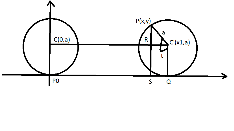

Ahaa... Ok... And how could we justify formally that the $x$-coordinate of the circle's center is equal to the arclength?
Is it as follows?
Let $P$ a point of the circumference of the circle. We suppose that the point $P$ starts from the point $P_0$, i.e., from the coordinate origin. If the circle rotates by angle $t$, the point that is on the $x$-axis is $Q=(x_1, 0)$ and the point $P$ moves to the position $P(x,y)$. If we unroll the circle we see that $x_1$ is equal to the arc length $PQ$, i.e., $x_1=at$.
We have $$x=P_0S=P_0Q-SQ=x_1-a\cos \left (\phi -\frac{\pi}{2}\right )=a\phi -a\sin \phi =a(\phi -\sin \phi ) \\ y=PS=PR+RS=a\sin \left (\phi -\frac{\pi}{2}\right )+a=-a\cos \phi +a=a(1-\cos \phi )$$
So the cycloid can be parametrized by $$\gamma (t)=a(t-\sin t, 1-\cos t)$$
Is everything correct? Could I improve something at the formulation? (Wondering)

Looks good to me. :)

Ok... Thanks a lot! (Mmm)
