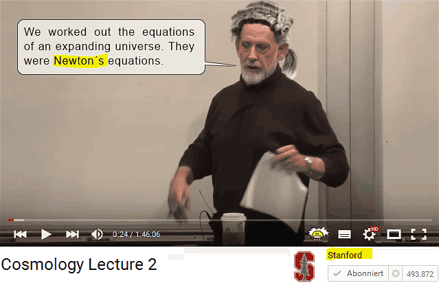

Dale said:
Newtonian gravity works on the scale of the Earth and moon, but it does not work at the scale of the universe.
For the most part it does:
Also see this, this, this and this reference on the subject. For the gravity in cosmology Newton does most of the job since it is rather weak; the relativistic equations give the same result like Newtons, with the little difference that the energy of light is inversely proportional to the scalefactor. But you don't need hardcore relativity in standard cosmology like you would in black hole astronomy, the formalism is completely Newtonian for the most part.
He said the "equations of an expanding universe" are "Newton's equations", but he does not mean the fundamental equations of Newtonian gravity. He only means the equations from one particular solution in Newtonian gravity. The fact that one particular GR solution happens to yield the same equations as one particular solution in Newtonian gravity does not mean Newtonian gravity explains the expansion of the universe. It just means the same equations happen to come out of GR in this particular case. You certainly can't use the fundamental equations of Newtonian gravity to derive this particular solution for the universe.

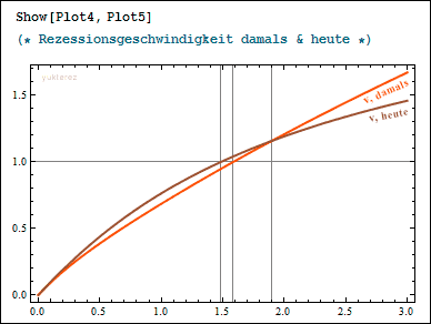

@PeterDonis @Yukterez the numbers are right, according to Jorrie's calculator. But the now-velocity of the galaxy and the emission-velocity was mixed up. I.e., it should read 3.62c at emission, and 2.08c now - not the other way around.
  • #31
Did I mix that up? If so, I of course meant it the other way around (:
Edit: I see, I was obviously too stupid to read my own chart (:

  • #33
Ah, got it.
  • #34
On the x-axis you have the redshift (as observed today), and on the y-axis the recessional velocity (orange is the velocity at emission and brown at absorption)
You see that objects with z < 1.8963 are faster today than they were when they emitted the light we receive now (the relative distance since then has changed more than the scale factor), while objects with z > 1.8963 are slower now than they were when they emitted their light (the expansion rate fell more than the distance increased while the light travelled).
