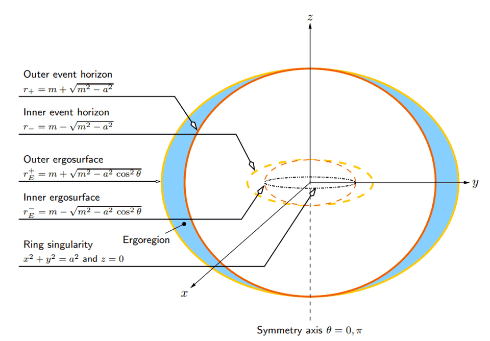

I'm confused because I thought some authors write that the singularity is shaped like a ring:
That's for a Kerr black hole, i.e., a rotating one. I have assumed that we were talking about a Schwarzschild black hole, i.e., a non-rotating one, since those are simpler to deal with.
But making the holes rotating doesn't make your description correct: Kerr spacetime is considered unphysical at the inner horizon, before you even get to the singularity (whereas there is no issue, at least at the classical level, with Schwarzschild spacetime all the way to the singularity).
