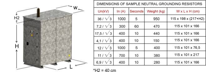

Generator's neutral is earthed through a huge high power resistor whose job it is to limit fault current to a value low enough it won't cause an electrical explosion inside the generator, twenty amps or less.. In my plant that resistor was the size of a pickup truck.
old jim
Likes KraakeCrest and Asymptotic
Indeed. I just Googled for an image and found this one. (compliments of http://www.kiantajhiz.com/en/Products/211)
Likes KraakeCrest, Asymptotic and jim hardy
To further Jim's comment... many older systems were Delta secondary, this had been preferred for reliability, as a single ground fault would not cause an outage since it would actually take 2 ground faults, typically on different phases to get the system to trip - but this was very dangerous and unreliable. Then rudimentary Ground Fault detection schemes were set up - the 3 light bulbs... often not causing a trip, but an indicator that there was a fault relying on those inconstant humans to monitor and take action..
Today - the wye secondary, has both safety and filtering benefits. Using a resistor on the neutral-grounding point connection when there is no neutral load, provides a known ground reference to the whole system. Or a known state. It is relatively easy to detect an abnormal conditions now by monitoring the current flow through the resistor. This can trigger an investigation or a system trip, all depending on the application, safety aspects, and reliability requirements. For example feeding a neighborhood the emphasis is on safety, feeding the back-up cooling of a nuke... well reliability.
So - for safety - you may be just wanting to limit the fault current, and trip almost instantly, for reliability, the system can be configured to allow a full time, continuous ground fault, setting off alarms, but not tripping off the system. Also - the Ground Fault current can be traced, sometimes allowing the location of the fault to be identified, and isolated without tripping the entire system.
