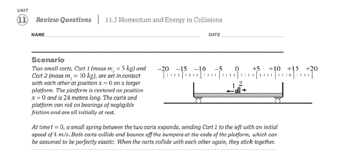

Two small carts, Cart 1 of 5 kg and Cart 2 of 10 kg are set in contact with each other at position x = 0 on a larger platform. The platform is centered on position x = 0 and is 24 meters long. The carts and platform can roll on bearings of negligible friction and are all intially at rest.
At time t = 0, a small spring between the two carts expands, sending Cart 1 to the left with an intiial speed of 4 m/s. Both carts collide and bounce of the bumpers at the ends of the platform, which can be assumed to be perfectly elastic. When the carts collide with each other again, they stick together.
Suppose the platform's wheels are free to roll, but the platform has much more mass than the two carts. If the experiment is repeated again exactly as before, will the center of the platform be to the left, to the right, or at x = 0 when the carts collide again and stick? Explain.

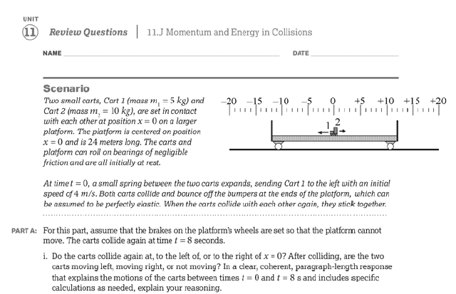

Sorry everyone, I should have added more info. Here is the problem and its full parts and my thinking:
Part A:
For Part A, I correctly calculated that the collision of the carts after they bounce back is to the right of x = 0 using Kinematics. This only happens however when the platform is braked such that it does not move at all.
Part B:
The reason why I assumed the collision was to the right was because of Part A when I calculated that their collision was to the right. However I now realize that I cannot assume that without justification. I am unsure now how to justify why they collide to the right now in the 2nd experiment, since wouldn't the cart moving be affecting the movements? Cart 1 isn't moving to the left at 4 m/s anymore (since momentum is now distributed among the 2 carts and platform now), so we can't exactly determine where they collide now since no velocities are known.

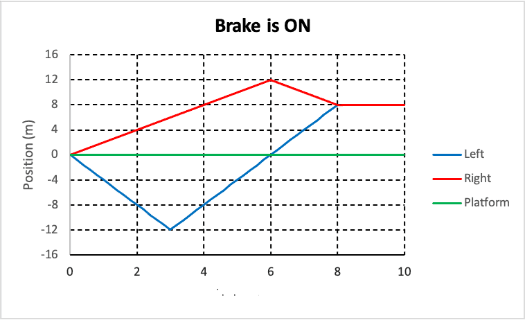

My thought process was that in Part A, when the platform was fixed to the floor, cart 1 travelled to the left at 4 m/s. Then using conservation of momentum it could be deduced that cart 2 travels to the right at 2 m/s. This can be transferred over to Part B where the cart is not fixed. Since it is so massive, it is basically fixed, so the information from Part A can be transferred over.
Since Cart 1 travels to the left faster than Cart 2 in terms of speed, Cart 1 hits its buffer first and bounces back with its exact same speed, just in an opposite direction.
Cart 1:
##t = 0## when explosion happens
##\Delta x = v_ot + 0.5at^2##
##12 = (4)t##
Cart 1 hits its buffer at 3 seconds.
Cart 2:
##12 = (2)t##
Cart 2 hits its buffer at 6 seconds.
To get where Cart 1 is when Cart 2 hits its buffer, elapsing another 3 seconds after Cart 1 bounces yields that Cart 1 travels another 12 meters, so now it is back at the origin (x=0) when Cart 2 just hits their buffer. It also tells us that they collide at t = 8 in Part A, so elapsing another 2 seconds yields that Cart 1 and Cart 2 collide to the right of x = 0. The platform moving affects it, but the platform doesn't move that much since it is just that massive.
Was my kinematics correct? (I haven't done it in a good few months so I might be wrong haha)

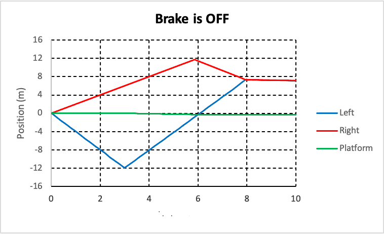

uSee2 said:
The platform barely moves in Part B, which means the velocities of the carts in Experiment 2 are nearly identical to the velocities of the carts in Experiment 1. This means we can still deduce that the carts still collide to the right of x = 0, since when the platform was braked they collided to the right of x = 0.
The carts colliding to the right of x=0 is not just a function of the cart velocities, which are admittedly nearly the same in both experiments. What is significantly different between parts A and B? How does that affect the collision location?
Yes, that's what I was after. And it follows from that that they will meet again well to the right.

The platform barely moves. That's true. Conservation of center of mass of system demands that. But the bolded statement above does not follow from the statement immediately preceding it, so the 'this means' parts is wrong.
I'd like to use a few numbers (like where the first collision takes place approximately, and the velocity thereafter), but none of these has been supplied so far and I'm not just going to blurt it out. I'll just say that there are regions along the line where the above bolded statement is not true, so the reasoning in post 12 is not solid.
About the new post:
At approximately 6 and 8 seconds respectively. The platform is massive, but not infinitely massive. Is it slightly more or less than 6 and/or 8 seconds? Where does the collision take place, near what point (value of x), and on which side of that point?
What is the end velocity of everything after the first collision?
I think cart 2 hits its bumper at approximately ##t = 3 \rm{s}## in the limit as the platform mass goes to ##\infty##. If the mass of the cart is finite, it reaches the right bumper in less than 3 seconds.
Never mind. Wrong platform half distance... :wideeyed:

For whatever it's worth, here is a plot of the positions of the two cart and platform as a function of time. The parameters of the masses are 1, 2 and 80 units (1 unit = 10 kg). The corresponding initial velocities were -4 m/s, +2 m/s and 0 m/s. When the two carts stick together their common velocity is -9.6×10-2 m/s while the platform's velocity is +3.6×10-3 m/s.
And here is the same plot with the brake engaged. I took the mass of the platform to be equal to the mass of the Earth, 6×1023 units.
On edit: Edited to address the issues about the plots raised in posts #35 and #36. See post #37.

I'm not sure if I'm intepreting this right, but why didn't the platform move much when the red cart (by that I mean the red line) collided with its buffer? Was it just because it was so massive?

I don't understand the green lines. Why do both suddenly jump from 0 to 12 when the light cart hits its buffer? And what does the mass matter in case A, with the brakes on?

Please see explanation below.
I understand the green lines. They are the result of my misguided effort at multitasking: simultaneously watch football on television, celebrate the impending arrival of the new year and post here. After the first three seconds the data points for the platform shift from the position of the center to the position of the right end. I have edited the post to fix that blunder.
The first plot addresses the situation "Suppose the platform's wheels are free to roll, but the platform has much more mass than the two carts." I considered a platform mass of 80 times the mass of the lighter cart to be "much more." The second plot addresses the engaged brake situation in which case the mass of the platform is equivalent to the mass of the Earth. I added plot titles to distinguish the two.
Finally, I should note my appreciation at the clarity of thought resulting from sobriety the morning after.
