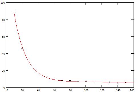

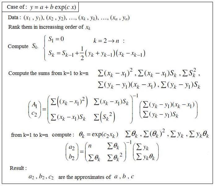

This is possible in the case of the fitting of the function y=a+be^c . This method is very simple because no iterative process is necessary. See the code in attachment.
With your data, the result is : a = 6.189453 ; b = 156.951617 ; c = - 0.065979
The graph below shows the result of the fitting.
Note : In this particular method, the criteria of fitting isn't the usual "mean least squares". The theory is given in
https://fr.scribd.com/doc/14674814/Regressions-et-equations-integrales (pages 15-17).
If you definitively want a "mean least squares" fitting, use any available convenient software with the above (a,b,c) values as initial guess. The iterative process in the software will give : a = 6.479641 ; b = 163.31383 ; c = -0.06931 . These values appear slightly different, but in practice the result is quite the same. The curves on the graph cannot be distinguished one to the other.
