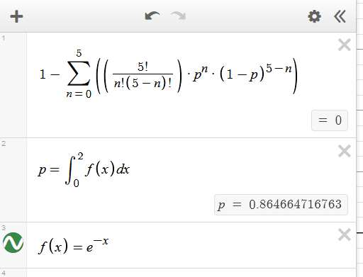

I have thought of this: Let ##p## be the probability that an airplane arrives within ##2## hours, then it makes a bit of sense to look at this as a probability of success in a Bernoulli trial.$$P(X>5)=1-P(X\leq5)=1-\sum_{i=0}^5{5\choose i}p^i(1-p)^{5-i}$$with ##p=\int_0^1f(x)dx##.
But this literally gives me ##0## using desmos calculator, which is not what I have found with the poisson model (either this is true, or the poisson model is).
Any guidance?
The airplane arrivals are not all with probability p. Once the first plane arrives, there are fewer than two hours left, so the second plane will arrive with probability smaller than p.
I didn't actually do the math, but the fact that you get exactly zero seems odd to me. And why is p the integral from 0 to 1 instead of the integral from 0 to 2?
