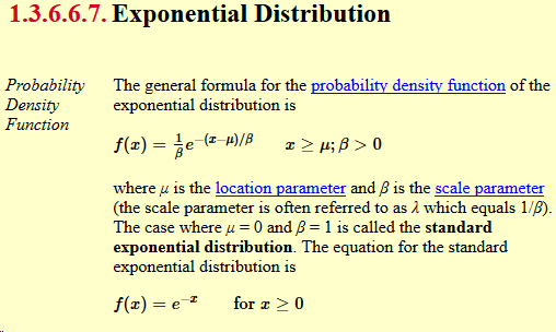

StoneTemplePython said:
$$f(x|\theta) = e^{-(x-\theta)}I_{(\theta,\infty)}(x)$$
is not the pdf of an exponential distribution. I think you are doing something else other than what you've literally stated here. The lack of Relevant Equations further adds to the ambiguity.
I am using this definition, with ##\beta=1## and ##\mu=\theta##. Also, I am using the indicator function to specify the domain.
Thanks, I see what you are doing now. Location parameter isn't a common term for an exponential distribution and I inferred ##\theta## was the rate (scale) parameter since ##\beta## was not mentioned.
It's good to follow your text but you should know that this is a very nonstandard formulation. I looked through several texts I have and they all define the exponential distribution as in here http://www.randomservices.org/random/poisson/Exponential.html
So for this problem the rate (or scale) parameter is 1, and you have ##X = Z + \theta## where ##X## is the stated random variable and ##Z## is the (standard) exponential distribution. In any case ##\theta## is a constant that is acting as an affine shift.
