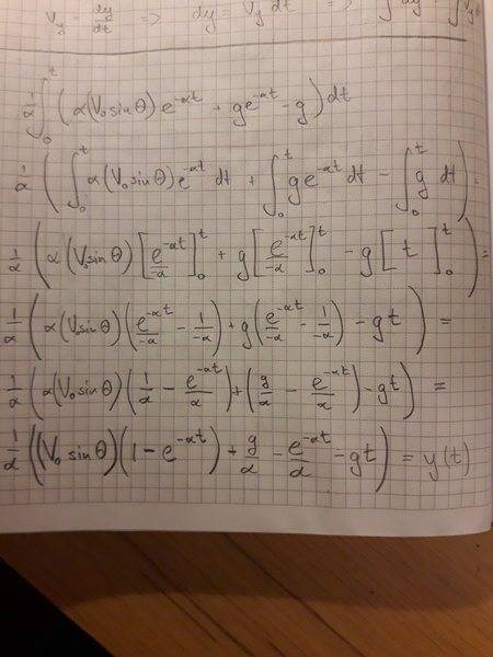

! Oh !
I forgot to mention that originaly, this was a 2D problem, so that is why I'm using ##v_0~sinθ## in my calculations on paper,
and not just ##v_0##, as I did in my post.
But I already solved for x-axis, so I didnt want u guys to think of any unnecessities, while helping me out.
So I just turned the whole thing into a 1d problem. I hope u don't mind. :)
And also I used ##b## instead of ##α##, just so it would be faster for me to write it down in ##LaTeX##.
So that's what I did to get there...
I still can't get this right. If u have any suggestions, u r more then welcome to share))
Many thanx!
Many thanx!
You're nearly there. The 1/a factors are ok now, but you forgot to multiply both terms with g here.
True story, my fault! Thank u)) How didnt I see this??
Was pretty close and even checked thrue integration several times... Now I got it right! Cant thank you enough))))))))))
