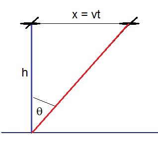

The directed beam from a small but powerful searchlight placed on the ground tracks a small plane flying horizontally at a fixed height h above the ground with a uniform velocity v. If the search light starts rotating with an instantaneous angular velocity ##\omega_0## at time ##t=0## when the plane was directly overhead, then at a later time t, its instantaneous angular velocity ##\omega(t)## is given by?

Make a picture, and everything will be clear.
How does the angle theta depend on time? How is the angular velocity ω defined?
The blue line represent the light beam at t=0, the red line is the light beam at a later time t.

l is changing, use vt/h = tan (theta) instead.

You have ##\theta = \tan^{-1}({vt/h})##
Differentiate it with respect to t. What do you get? Remember v and h are constants.

Differential of ##Tan^{-1}x = \frac{1}{1+x^2}##
so then ##\omega = (1/1+(vt/h)^2 )* v/h##
substituting ##v=l\omega##
##\omega = 1/1+(l\omega t/h)^2 * v/h##
and I end up with ## \omega = \frac{\omega }{h/l+l\omega^2t^2/h}##
I found where I made mistake 'v' should be, ##v=h\omega_0##
and with that substitution
I get the answer ## \omega = \frac{\omega_0}{1+\omega_0^2t^2}##

That is wrong. You've just derived the expression for ω, it is not v/L.
You have to find ω0, the angular velocity at t=0. Substitute t=0 into the equation for ω, what do you get?

Well, I did not see. You got it at last!
Next time remove the wrong part from your post.
