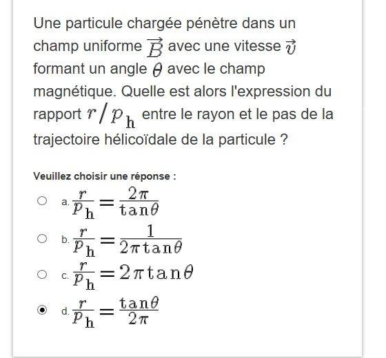

charged particule reaches a uniform magnetic B field with a velocity V , and at angle theta with the magnetic field .
What is the expression of the relation , expressed as a ratio, of the radius and helical step of the trajectory of the particule .
a- 2pi/tan a
b- 2pi tan a
c- 2pi tan a
d- tan a / 2pi

question only asks for the expression for raduis and helical step . .
the expression with i used that ended up with mass was the formula for radius in circular motion , and the other formula is for the helical step. i know that charged particle will travel in circular motion, not helical, if the magnetic field is orthogonal to the particle velocity's direction.
helical motion happens when the field is not 90 degree to the velocity ..
so i should use the radius from the helical motion and the helical step . so this question is only about helical motion then,
velocity vector has 2 components ;
v cos phi is for the helical step
v sin phi is for the helical radius
parallel velocity * period = ( v cos phi )*2pim /qB
book says the orthogonal velocity determines the radius , and should be substituted for v in the equation r = mv /qB
the only equation i have which does not have the mass is for the period T= 2pir / v or 2r = 2/B square root (
i have no equations for the radius or helical step that do not take the mass into account. ...
Even stronger: it asks for the ratio !
True, but not efficient: you want r/ph so it is much smarter to write ##v_\parallel * T = 2\pi r ##
and then write a comparable expression for ph
Divide the two and you are done.

so if i guess from your previous posts, the radius i used was not the correct one
That was indeed what I meant: only the component ##\perp \vec B## counts.
thee qs said:
so the radius and helical step has to only be dependant on the parallel and perpendicular velocity components.
No: m, q and B also come in. But for the ratio r/ph everything cancels, except ##\theta##.

I don’t think it is.
BvU and I have said that things cancel out nicely to give the answer. To exemplify this, let me re-ask the question, but without the magnetism:
“If I travel in a helix of radius R, with a ‘circular’ speed Vsinθ and ‘transverse’ speed Vcosθ then what is the ratio of helical step to R?”
Remember, the helical step is how far you move transversely during one circular loop.

1/0 doesn't exist . having cos 90 at denominateur will make the entiere fraction divided by 0 . even then , it would mean C would be the answer which it isn't , and since it isn't D . it has to be A.
well the correct answer was D.
which is the answer i withe method i had used.
and this question counted for 1% of my final grade...
well thx
god, i had the right answer all along, and been trying for 3 days to understand people explaining to me the incorrect answer
so apparently i was right all along folks, should of trusted my judgement first
Point is that at 90 degrees r/ph is also '1/0', so that is a nice agreement -- excludes answers a and b, just like you reasoned (#10), but (ambiguously?) described 'no good' in #13.
Of course it is D . It's not the 1% that counts here: you can get top grades if you can fine-tune your method of work to let careful steps and meticulous math replace impression and judgement.
