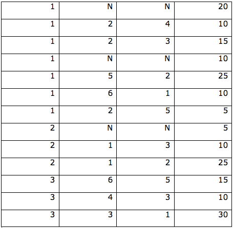

Hi all,
I need to rearrange my data. I have an excel file with 12 columns and 2045 rows, which I transformed that into a .mat.
I need to query my data rearranged as follows (cf. example matrix below):
1-sum all values of Col 3 if:
a-they belong to a given value of Col 1 and to a given value in Col 2.
2-mean of values of Col 4 for each given value of Col 1
3-NaN's where conditions above are not met
4-all saved in a new matrix
The difficulty is to make this work for the 2045 rows of my database. I guess it needs a for-loop that reiterates the calculations and at each step saves the values in a matrix.

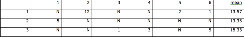

This is what I'd like to get:
1 2 3 4 5 6 Mean
1 NaN 12 NaN NaN 2 1 13.57
2 5 NaN NaN NaN NaN NaN 13.33
3 NaN NaN 1 3 NaN 5 18.33
I'd really appreciate your help and will include you in the acknowledgments of the 2 papers I will get out of this.
Thanks a lot!
g

Can you be more specific? The example you gave wasn't very clear, but this should be a simple problem to overcome. For ex, the first row in your "desired output" has 6 values, and the rest have 8..

Here is what my data means in real life:
Input matrix
Rows are individual observations
Col 1 = transect number
Col 2= species code
Col 3= count of animals of corresponding species
Col 4= % ice cover for that specific observation
Ouput:
Col 1= transect number
Col 2 to Col 7 = sum of animal counts of species 1 to species 6
Col 8= mean ice cover for corresponding transect
N=NaN
Thanks!

I'll write up an m-file that works on that data, but you'll probably need to edit it to make it work with your actual data (since it has more columns and possibly more than 3 transects)

I wrote this up quickly so there are likely ways you can improve it. For the time being, it returns your desired output.
Code:
%sample data matrix, A
A = [1 NaN NaN 20;1 2 4 10;1 2 3 15;1 NaN NaN 10;1 5 2 25;1 6 1 10;1 2 5 5;2 NaN NaN 5;2 1 3 10;2 1 2 25;3 6 5 15;3 4 3 10;3 3 1 30];
%Change NaN's in A to zeros for summing purposes
A(isnan(A))=0;
%Change these vars to match real counts
Transects = 3;
Species = 6;
%Preallocate output
Out = zeros(Transects,8);
for i = 1:Transects
    %First column is just transect number
    Out(i,1) = i;
    %B is the subset of A for current transect
    B = A(A(:,1)==i,:);
    %C is the subset of B for current species
    for k = 1:Species
        C = B(B(:,2)==k,:);
        Out(i,k+1) = sum(C(:,3));
    end
    %Ice cover means
    Out(i,end) = mean(B(:,4));
end
%Convert the zeros back to NaN's
Out(Out==0)=NaN;
Since a numeric matrix in MATLAB cannot have an empty entry or a char like 'mean', this output is identical to your desired output without the first row. You'll just have to remember that column 2 is species 1, column 3 is species 2, etc...
