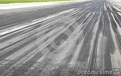

Ever noticed how long are those skidmarks at end of runway ? Well, those tires are expensive.
It only takes about one second to spin up a wheel on contact. The skid marks look long because many aircraft land, all in slightly different places. The skid marks heat the tyre and so give some initial braking. The heat also prepares the tyre temperature and pressure for the braking process.

140 knots is 236 feet per second which is a long burnout.
They look small from an airliner window forty feet off the ground..
Through the windshield of a little Cessna they look immense.
Airliner tire life ranges from ten to 300 landings.
