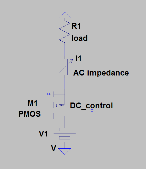

Audio frequencies. The application is an amplifier where I need an adjustable impedance at a DC bias point. The DC adjustment will be done via a source follower but the signal needs a separately adjustable attenuation.
I tried using a mosfet in LTspice in parallel with a resistor to create a variable resistance but for some reason it never reaches the source voltage when the resistance becomes zero. For example if the source voltage is 100v then at zero resistance the other size of the resistor should be 100v, but it comes out much lower. Is this a glitch in LTspice or is there some reason for this?
Can you post a block diagram of what you are trying to do?
Source follower sets the bias voltage for the load. I need to adjust the AC signal as well, hence my problem.
coinmaster said:
https://www.physicsforums.com/attachments/96634
I'm not able to see the circuit parts -- they are too light for my viewer. Can you post a darker/enhanced version? Thanks.
Edited.
