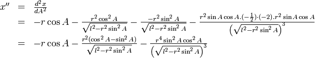

Using the equations derived for the motion of a piston:
http://upload.wikimedia.org/wikipedia/en/math/1/6/8/1686ee2f8b1d67ce1eb1aa4fb4b0daac.png
Gives you this:

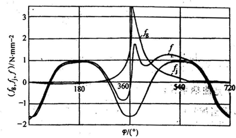

Sorry, I should add why I'm asking this. I have the following diagram:
Where f_g is the combustion force, f_j is the inertial force and f is the resultant force. I'm trying to work out what's providing the force to overcome the acceleration around 650 to 90 degrees.
