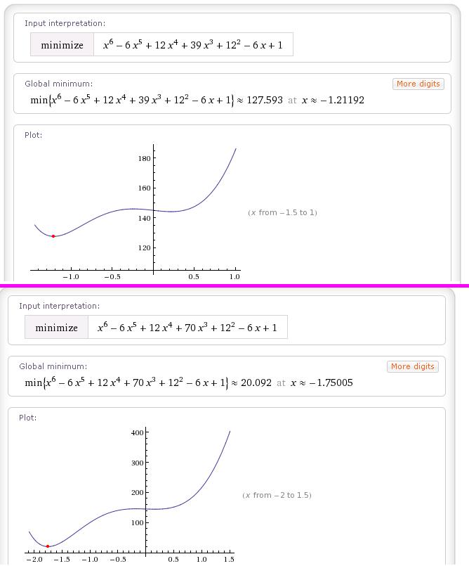

I hate to keep bothering you but when I let $a$ to lie outside the interval of which you found, for example $a=39$ and also $a=70$, I noticed that the original function of $x^6-6x^5+12x^4+ax^3+12x^2-6x+1$ is always greater than zero as well...(Worried)
Check your terms that are supposed to contain $x^2$. The variable is missing and you have $12^2$ instead. :D
Oh my...I'm sorry! This is probably the most silly blunder that I have ever made this year!
Now, everything looks fine and good to me.
Thanks to both of you and Opalg for the guidance on how to tackle the problem correctly.
