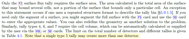

where is the output for multiple F5 tally detectors
The MCNP manual states that you can have multiple detectors for a single F5 tally. Say you have f15:n x1 y1 z1 r x2 y2 z2 r.....Thing is, my output file only lists the tally result for the first f5 detector (x1,y1,z1). Where are other detectors for this tally? Is there a reason code developers enabled this method of defining multiple detectors vs just using f15, f25, f35....for each one?

Hey Alex - so yes, F15, F25....can be used separately but this option allows you to use F15 and then list multiple detector locations (not ring or a sum...the results appear to be as if you separately assigned a tally number to each). Discussion in the manual is limited, but in latest manual online (MCNP 6.3), this is the statement below. It looks like only the first detector belonging to the tally is in the output file, the rest are in the .m file but minimal labels (not user friendly at all)

F1,2,3,4,6 and 7 don't involve detectors, they use an existing object. MCNP5 and later allows many objects on the same tally and how the results are shown depends upon parentheses.
MCNP5 only allows one ring or point per tally but the same note is in the MCNP5 manual, just meaning F5 can do point arrays (and maybe other reasons) so don't expect to do 20 (the detector limit for that version) F5 tallies under all circumstances.
X 2.6.0, 6.2 and 6.3 manuals allow multiple ring and point detectors per tally and the expected behavior is that is write a tally total as well as individual results for each detector unless this is suppressed with the 'ND' keyword.
The 6.1 and 6.1.1 manuals are maybe unhelpful, and they appear to be derived from the MCNP5 manual, so the behavior might not match the code.
So yeah, unless you are using the 'ND' keyword you should see a result for every detector on the line according to the manual. I also have no idea what the .m file is. :)
