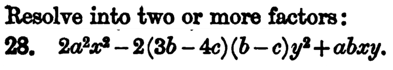

Resolve into two or more factors : ##\large{\boldsymbol{2a^2x^2-2(3b-4c)(b-c)y^2+abxy}}##.
1. ##a^2-b^2=(a+b)(a-b)##
Statement of the problem :
Let me copy and paste to the right the problem as it appears in the text.

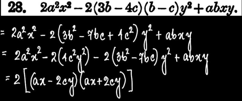

Attempt : I couldn't go far into the solution. Below is my hopeless attempt.
Request : Any hints would be welcome.
[There are no solutions provided, but the answers are at the back of the text. I don't want to cheat my way out by looking at the factorised answer and then working my way back, though I admit it can lead to some learning too in the process]

brotherbobby said:
Homework Statement: Resolve into two or more factors : ##\large{\boldsymbol{2a^2x^2-2(3b-4c)(b-c)y^2+abxy}}##.
Relevant Equations: 1. ##a^2-b^2=(a+b)(a-b)##
View attachment 339261Statement of the problem : Let me copy and paste to the right the problem as it appears in the text.
Why not multiply back your factored form see if you get back your initial expression?

Given the coefficient of [itex]x^2[/itex] is [itex]2a^2[/itex], it makes sense to look for a solution [tex]
2(ax + By)(ax + Dy) = 2a^2x^2 + 2a(B + D)xy + 2BDy^2.[/tex] Since [itex]p = B + D[/itex] and [itex]q = BD[/itex] are known, we can find [itex]B[/itex] and [itex]D[/itex] as the roots of [tex]
z^2 - pz + q = 0.[/tex]
Since those factors involve square roots, we can instead try [tex](2ax + By)(ax + Dy) = 2a^2x^2 + a(B + 2D)xy + BDy^2.[/tex] which leads to [itex]B + 2D = b[/itex] and [itex]BD = -2(3b - 4c)(b - c)[/itex] which by inspection has a solution [itex]B = -(3b - 4c), D = 2(b - c)[/itex].
