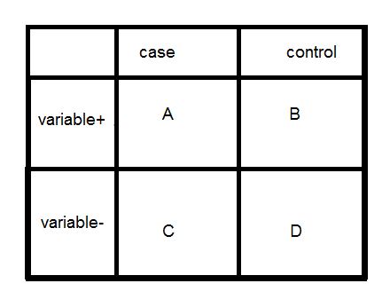

To reiterate my concern about deriving the odd for the disease given the variable(s) from the odd of the variable given the disease. As I mentioned, I am doing a retrospective study where the odd of the variable given the disease can be calculated. However, my real concern is calculate the odd of the disease given the variable(s). Because this is what matters for the doctor and the patient who is presented by some variable(s).
I am thinking to do the following: I can conduct a retrospective study as usual and derive the odd of the variable(s) given the disease as expected. Then calculating the probability of having the variable given the disease p(variable I disease), from the logistic regression. Finally convert that probability to probability of having the disease given the variable from Bayes` equation p(disease I variable) = π(disease) p(variable I disease) / [ π(disease) p(variable I disease) +π(normal) p(variable I normal) ]. Where, normal, stands for the normal cases without the disease, π(disease) is the prevalence of the disease in the population and π(normal) is the prevalence of the normal in the population.
Need your opinion. Thanks.
