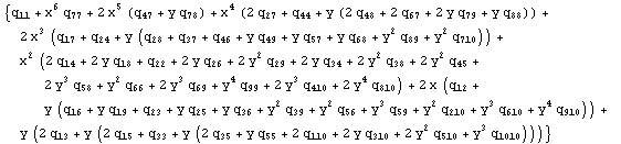

Hello, I have a long equation
and using Mathematica 7 I want to factor out terms such as x,y,xy, x^2y,xy^2, etc. so that I'll have it in a form similar to
a + b*x + c*y + d*(xy) + e*(x^2y) + f*(xy^2) + ...
I've tried using the Collect by passing {1,x,y,xy,x^2y,x y^2,...} as the terms to be collected but haven't been successful, I'd appreciate any help!
Thanks!

Well, #1 your :
{1, x, y, x^2, y^2, xy, x^3, x^2 y, xy^2,
y^3}
the xy parts need to have spaces "xy"-> "x y" or xy is a new variable.
Also, the second vector, why do you have the double {{},{},{},..}
Third, how about :
Code:
f = {1, x, y, x^2, y^2, x y, x^3, x^2 y, x y^2,
    y^3}.{{Subscript[q, 11], Subscript[q, 12], Subscript[q, 13],
     Subscript[q, 14], Subscript[q, 15], Subscript[q, 16],
     Subscript[q, 17], Subscript[q, 18], Subscript[q, 19],
     Subscript[q, 110]}, {Subscript[q, 12], Subscript[q, 22],
     Subscript[q, 23], Subscript[q, 24], Subscript[q, 25],
     Subscript[q, 26], Subscript[q, 27], Subscript[q, 28],
     Subscript[q, 29], Subscript[q, 210]}, {Subscript[q, 13],
     Subscript[q, 23], Subscript[q, 33], Subscript[q, 34],
     Subscript[q, 35], Subscript[q, 36], Subscript[q, 37],
     Subscript[q, 38], Subscript[q, 39],
     Subscript[q, 310]}, {Subscript[q, 14], Subscript[q, 24],
     Subscript[q, 34], Subscript[q, 44], Subscript[q, 45],
     Subscript[q, 46], Subscript[q, 47], Subscript[q, 48],
     Subscript[q, 49], Subscript[q, 410]}, {Subscript[q, 15],
     Subscript[q, 25], Subscript[q, 35], Subscript[q, 45],
     Subscript[q, 55], Subscript[q, 56], Subscript[q, 57],
     Subscript[q, 58], Subscript[q, 59],
     Subscript[q, 510]}, {Subscript[q, 16], Subscript[q, 26],
     Subscript[q, 36], Subscript[q, 46], Subscript[q, 56],
     Subscript[q, 66], Subscript[q, 67], Subscript[q, 68],
     Subscript[q, 69], Subscript[q, 610]}, {Subscript[q, 17],
     Subscript[q, 27], Subscript[q, 37], Subscript[q, 47],
     Subscript[q, 57], Subscript[q, 67], Subscript[q, 77],
     Subscript[q, 78], Subscript[q, 79],
     Subscript[q, 710]}, {Subscript[q, 18], Subscript[q, 28],
     Subscript[q, 38], Subscript[q, 48], Subscript[q, 58],
     Subscript[q, 68], Subscript[q, 78], Subscript[q, 88],
     Subscript[q, 89], Subscript[q, 810]}, {Subscript[q, 19],
     Subscript[q, 29], Subscript[q, 39], Subscript[q, 49],
     Subscript[q, 59], Subscript[q, 69], Subscript[q, 79],
     Subscript[q, 89], Subscript[q, 99],
     Subscript[q, 910]}, {Subscript[q, 110], Subscript[q, 210],
     Subscript[q, 310], Subscript[q, 410], Subscript[q, 510],
     Subscript[q, 610], Subscript[q, 710], Subscript[q, 810],
     Subscript[q, 910], Subscript[q, 1010]}}.{1, x, y, x^2, y^2, x y,
    x^3, x^2 y, x y^2, y^3};
CoefficientList[Expand[f], {x, y}]
F[i_, j_] := CoefficientList[Expand[f], {x, y}][[i+1]][[j+1]];
F[1, 3]
So it makes an array of the coefficients of the powers of x and y. So F[1,3] would be whatever is in front of x y^3.
