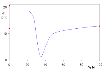

I don't think it's simple. Here's the coefficient of thermal expansion for Fe/Ni alloys as the Ni composition varies. Note the sharp minimum at 36%.
Oh, definitely. My link shows only the trend for elements, and even then the correlation isn't absolute. With ferritic alloys, you're going to get some coupling with magnetism that could complicate things tremendously. (Or let you design a cool low-thermal-expansion material, depending on how you look at it!)
