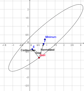

The gradient descent approach has a speed problem converging to a minimum for an ill-conditioned situation. If the objective function is a long, narrow valley, the gradient descent tends to zig-zag across the narrow dimension like a sowing machine slowly traveling in the long dimension toward the minimum. More advanced algorithms first normalize the long-narrow valley to a circle so that the direction of each iterative step points more directly to the minimum.
PS. If the objective function really is a simple ellipse, the steepest descent would take a large second step toward the minimum and be fast. But any distortion of the objective function can fool the steepest descent algorithm and make it very slow.
Likes aphirst
