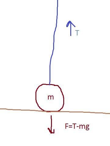

You need to draw a force diagram and include gravity. You just can't equate the F=ma and F=kx equations together.
So basically you have two cords which behave according to hooke's law (assumption?) and gravity.
When at rest with a person in the harness, the forces are at equilibrium.
So, when they're pulled all the way down and clipped to the floor this would occur?
EDIT: Actually, no?
If they were in equilibrium, [itex]F = T[/itex]
meaning [itex]mg = T[/itex]?
In your force diagram, the downward arrow is simply -mg and the sum total of forces F = T - mg.
Eventually though you need to draw a force diagram for the whole system including each cord because you're assuming the sum total of cord tension behaves according to hooke's law and I don't think it does even if individually the cords do.
At equilibrium, the cage is at rest (= zero acceleration) hence sum total of forces is zero 0 = T - mg so T = mg in that case and from there you can compute k given the elastic rope displacement (the x0 in the T=kx0 equation).
Another thing you need to consider is that as the person rises the tension drops to zero and he continues to rise a bit more and then the cord tension will start to pull him back down.

Okay, so I can calculate k with [itex]k=\frac{T}{x_{0}}[/itex] where [itex]{x_{0}}[/itex] is some change in length that I decide. I'm not sure how this would help me find the maximum height and speed though as I've already technically worked out T from [itex]T=mg[/itex]
