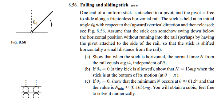

Falling and sliding stick (David Morin)
In summary, the equation of translational motion for the center of mass is ##N-mg=ma_y##, and the purpose of ##N ## is only to keep the pivot so that it is still on the rail.
Father_Ing
33
See attachment
F= ma
Introduction-to-Classical-Mechanics.pdf - Profile 1 - Microsoft​ Edge 05_12_2021 16_29_13 (3).png
In the solution for question ##(a)##, it is written that the equation of translational motion for the center of mass is ##N-mg=ma_y##
Why ##N## is also included inside of the equation? In my opinion, the rail does not exerting force (N) to slow down the mass' acceleration. Instead, the purpose of ##N ## is only to keep the pivot so that it is still on the rail.
Can anyone please explain to me why ##N## is also included in the calculation?

There must be an upward force at the pivot. Otherwise, the stick would simply be in freefall and the CoM would fall vertically under the force of gravity alone.
Alright...
But, after thinking it over again, why not ##N - mg## = 0?
The stick does not falling freely,but it only rotates. Which means that there is no translational motion.Hence ##a_y = 0##

If ##a_y = 0## then the stick will move horizontally! The CoM of the stick must have vertical motion.
Father_Ing said:
the purpose of N is only to keep the pivot so that it is still on the rail.
It is not still. The rail is frictionless, so can only exert a vertical force. What does that tell you about the trajectory of the mass centre of the stick?
And it must exert a vertical force to cause the stick to rotate.

The stick falls, therefore ##a_y \ne 0##. Assuming ##a_y## refers to the vertical acceleration of the CoM. The vertical acceleration of the bottom of the stick is zero.
If you are talking about rotation about the CoM, then that cannot cancel the translation of the CoM. In this case, the CoM translates (falls); and, the stick rotates about its CoM.
why is the rotation not about the pivot, like in the case where the pivot is restrained?
It doesn't matter whether you want to think of it as a rotation about one end, or as a rotation about the mass centre plus a vertical motion of that. You cannot get away from the fact that the mass centre accelerates according to the net force. ##\Sigma F=ma##. The mass centre does accelerate downwards, so there is a net vertical force.

You can model the system as motion of the pivot and rotation about the pivot. That should give you the same physical solution. In general, you can choose any point on the stick and decompose the motion into translation of that point plus rotation about that point.
In any case, the external forces on the stick are the same: they are ##mg## and ##N##, both vertical. And, that determines the translational (linear) motion of the CoM.

It is not. In the fixed pivot case, some of the energy goes into horizontal motion, slowing the descent.

You need to be careful there. The pivot itself is accelerating horizontally. In that reference frame, you would need to add a fictitious horizontal force through the CoM.

You wanted to use the pivot, which is accelerating to the left. That's a non-inertial frame. Newton's laws do not directly apply in a non-inertial frame. You need to include relevant fictitious forces.
Consider this: imagine the stick is falling horizontal (no pivot, just simple freefall). Now, do an analysis of forces about one end of the stick. There is a torque ##mgL/2## about the end. But, there is no rotation. That illustrates the problem of using an accelerating point on an object (that is not the CoM) and trying to apply Newton's laws.

When the rod is horizontal at ##\theta = \pi/2##, the vertical acceleration of the mass centre is ##-l\dot{\omega}/2##. The vertical force is ##N - mg##, so\begin{align*}
N - mg &= -\dfrac{ml\dot{\omega}}{2}
\end{align*}The moment about the mass centre is ##G = N l/2##, so \begin{align*}
\dfrac{N l}{2} = \dfrac{1}{12} ml^2 \dot{\omega} \implies \dot{\omega} = \dfrac{6 N}{ml}
\end{align*}which allows you to eliminate ##\dot{\omega}##. For ##(\mathrm{b})##, you should consider energy.

The rod as a whole is not going left, so you do not need a force going left. The motion is vertical for the rod as a whole, plus a rotation. The rotation comes from the torque that arises because the normal force is left of the gravitational force.
If it still bothers you when considering the rod as made of small elements, you could say the leftward force on the leftmost element comes from the reaction from the rightward acceleration of the rightmost element, and v.v.

Because the rod is rigid, so each particle transfers force and torque to the next.

Yes, each particle on the rod must be subject to the force required by the constraint that the rod remains rigid. ##N## is an external force applied at the pivot. ##dN## doesn't make sense in this context.
There will be a distribution of internal forces along the rod. If you have calculated the motion of the rod, you may calculate the motion of every point on the rod and hence the force on that point.
The point is that the internal forces cancel (Newton's third law) and the external forces determine the motion. Unless the rod breaks, the internal forces are irrelevant.
