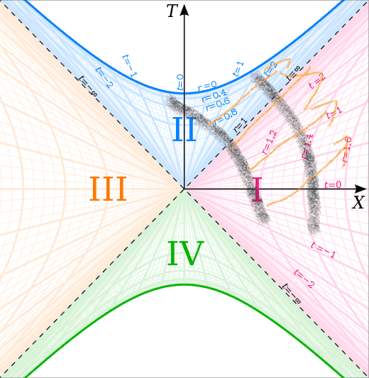

I'd use Kruskal-Szekeres coordinates, because then you can draw a Kruskal diagram (with apologies to @DrGreg, whose diagram I've defaced):
In this diagram, the outside world (or at least a slice of it) is distorted into the right hand wedge (the red region labelled I) and the interior of the hole is the upper wedge (blue, labelled II). The other two regions don't matter here (and don't exist in a realistic black hole). The event horizon is the boundary between I and II, and the singularity is the curve at the top of the diagram.
An important feature of this diagram is that light moving radially inwards moves on a 45° line sloping up to the left, and outward moving light follows a 45° line up to the right - parallel to the event horizon.
I've sketched the paths of two infalling observers in black. The left hand one is your toes, emitting pulses of light (orange arrows). All pulses emitted before your toes cross the horizon are received by the second observer (your eyes) before they cross the horizon. All pulses emitted after your toes cross the horizon are received after your eyes also cross. Given that you can pick a coordinate system where the light rays' worldlines are parallel to the event horizon, how could it be otherwise?
