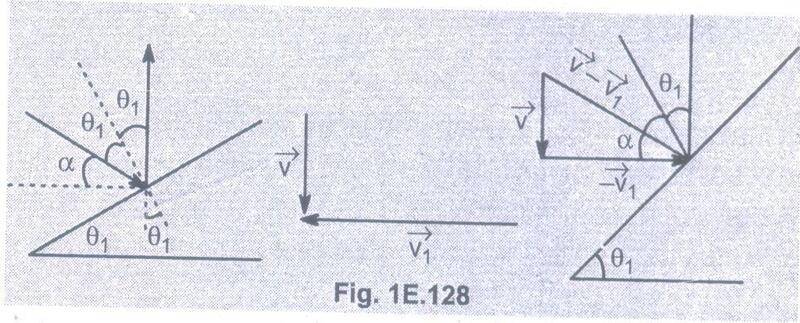

Two motor cars have their wind screens at ##\theta_1=15^{\circ}## and ##\theta_2=30^{\circ}## respectively. While moving in a hailstorm the drivers see the hailstones bounced by the wind screen of their cars in the vertical direction. What is the ratio ##\dfrac{v_1}{v_2}## of the velocities of the cars ##?## Assume the hailstorms fall vertically.
SEE HW STMENT
I tried to construct a diagram, but to no avail, since I don't really understand the qn. However, my professor provided me with this graphical depiction (that i obviously don't understand)
Book's vector diagram

Hailstones bounce in the vertical direction which implies that the angle of reflection is ##\theta_1## as shown in figure, which is same as angle of incidence in the cars' reference frame. Velocity of hailstones relative to the first car is ##\dfrac{v_1}{v_2}## as shown in the figure.

There is some confusion in the subscripts.
Since the windscreen angle is drawn differently in the left and right diagrams I assume these are for the two cars, but both diagrams show ##\theta_1, v_1##, both use ##\alpha## instead of ##\alpha_1, \alpha_2##.
The speed of the hailstones relative to that of the first car is ##\frac v{v_1}##, not ##\frac{v_1}{v_2}##.
What is the relationship between ##v, v_1, \alpha_1##?
What is the relationship between ##\theta_1, \alpha_1##?

Look at the right hand diagram. There is a triangle with sides labelled ##v, v_1## and an angle ##\alpha##. What equation relates them, given that v is vertical and v1 horizontal?
Look at the left hand diagram. What is the angle between the horizontal dashed line and the vertical arrow? What angles lie between them?

Fixing up your LaTeX and other details:
DifferentialGalois said:
##\alpha_1 + 2\theta_1=\frac{\pi}{2} ## and ##\tan{\alpha_1}=\dfrac{v}{v_1}##
but i still dont understand how they constructed that diagram.
The diagram is using a graphical way to add vectors.
The hail has a vertically down velocity of ##v##. In car 1's frame of reference it also has a horizontal velocity to the right of ##v_1##. Adding these two vectors gives the velocity of the hail relative to car 1.

I think you have a solution, but you don't understand it. The key point is that when we move to the car's reference frame, the velocity of the hailstones (in that reference frame) has the same vertical component (##v##) and also a horizontal component ##-v_1## or ##-v_2## respectively.
At this point you can analyse the scenario as if the car were stationary and the hailstones were being fired it at an angle with these velocity components.
A bit of trigonometry is needed to show that, if the windscreen is at an angle ##\theta## with the horizontal, then the angle of incidence of the hailstones is also ##\theta##. Given that the hailstones bounce vertically in the car frame. This is the diagram you were given.
That's all you need to derive an expression for ##\frac {v_1} v## in terms of ##\theta_1## and the same for ##v_2##.
You can then put these equations together to express the ration ##\frac{v_1}{v_2}## in terms of some trig function of ##\theta_1## and ##\theta_2##.
The solution involves these four steps and the associated calculations. Can you identify which parts of this solution you do not understand?

You have the following equation(s):
$$\alpha_i + 2 \theta_i = \frac{\pi}{2}$$
The value of ## \theta_i ## is fixed for each car. What is ## \alpha_i ## in terms of ##v,v_i## for a particular car?
Likes berkeman and Steve4Physics
Hi @DifferentialGalois. For the moment, forget about the original problem. Can you answer this...
A hailstone is falling vertically downwards at speed ##v## relative to the ground
You are driving (on the ground, straight and horizontally) at speed ##u## relative to the ground (and the hailstone's trajectory is directly in front of you).
In your (the car’s) frame of reference the hailstone appears to be moving at angle ##\alpha## to the vertical.
Can you find a formula for ##\alpha## in terms of ##u## and ##v##?
