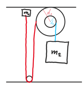

The following situation:
The pulleys are fixed to the floor/ceiling and massless, as are the ropes, and there is no friction. At ##t=0##, the masses are released from rest.
For the moment, I'll assume ##m_2\gg m_1##. So ##m_2## will accelerate at ##g## and the red rope at ##\frac{d_1}{d_2}g##. How do I now find the accelerations of motion for ##m_1##?
At the very beginning, as far as I can see ##m_1## experiences a downward force ##F_1=m_1 g+\frac{d_2}{d_1}m_2 g##. But I'm quite sure the tension in the red rope decreases, but how exactly?
Hi,
you want to write down a few equations. choose/define relevant variables and work towards ##N## equations with ##N## unknowns.
What about the tensions in the red rope at the (massless!) lower pulley ?
And tensions in the red and blue ropes at the upper pulley ?
And the in the blue rope is related to the acceleration of ##m_2##

If ##m_2 \gg m_1## then we can treat the downward acceleration of ##m_2## as being fixed. You already realize this.
This means that the downward acceleration of ##m_1## is also fixed. (Assuming ##d_2 > d_1## so that the rope does not go slack).
What is the resulting acceleration of ##m_1##?
What forces act on ##m_1##?
Which of those forces do you already know?
Does this allow you to calculate the remaining force?

Constant yes. But I mean that it is "determined". Given what you already know, there is only one value it could possibly be.
But if the blue rope accelerates at ##g##, then the red one does so at ##\frac{d_1}{d_2}g##. And if my ##F_1## from #1 is correct and constant, then ##m_1## accelerates at ##g+\frac{d_2}{d_1}\frac{m_2}{m_1}g## which is bigger than ##\frac{d_1}{d_2}g## given that ##\frac{m_2}{m_1}\gg 1##.
This would mean that the rope goes slack immediately. But then again ##m_1## falls freely at ##g##, allowing the rope to tension again and so forth... What's wrong?

Huh? You have given no valid computation for ##F_1##.
What you know is how ##m_1## moves. You can use that to calculate what ##F_1## must be.
I used the law of the lever on the wheel and axle and added this force to the gravitational force acting on ##m_1## (but I see now that this can't be right).
jbriggs444 said:
What you know is how m1 moves. You can use that to calculate what F1 must be.
Huh? That seems backwards to me. How would I know how ##m_1## moves without knowing ##F_1## first and calculate the acceleration out of that?
EDIT: Ah, I see. If there's no slack, ##m_1## obviously has to accelerate at the same rate as the blue rope.

Okay, that makes my initial question trivial. I was way too focused on finding the forces first to realize that the acceleration can be calculated right away.
So ##a_1=\frac{d_1}{d_2}g## and since ##F_1=m_1 a_1=m_1 g+T_r##, the tension in the red rope is
$$T_r=\frac{d_1}{d_2}m_1 g-m_1 g=\left(\frac{d_1}{d_2}-1\right)m_1 g\ .$$
However, now the law of the lever
$$T_r\cdot d_1=T_b\cdot d_2=m_2 g\cdot d_2$$
seems to fail completely. Is this an artifact of ##m_2\rightarrow\infty## or does that generally not hold for accelerated systems?

Since ##m_2## is accelerating there must be a net force on it, so ##T_b\neq m_2g##.

Ah, I see. I think I'm running into trouble here because of my assumption that if ##m_2\gg m_1##, then ##m_2## is "practically" free falling, which would mean that ##T_b\approx 0## (right?), but on the other hand still having ##m_1>0## which means that ##T_b=\frac{d_1}{d_2}T_r>0## (but still small, so so it kind of works out).
I guess I should try and tackle the full problem without approximations.

Okay. For consistency, let ##T_1=T_r## and ##T_2=T_b##. I'll assume no slack, which means ##a_1>g## (otherwise, both masses are free falling). Then I get the four equations:
$$\begin{aligned}
m_1 a_1&=m_1 g+T_1 \\
m_2 a_2&=m_2 g-T_2 \\
\frac{a_1}{d_1}&=\frac{a_2}{d_2} \\
T_1 d_1&=T_2 d_2
\end{aligned}$$
I used a CAS to solve this for me:
$$\begin{aligned}
a_1&=d_1 g\cdot\frac{d_1 m_1+d_2 m_2}{d_1^2 m_1+d_2 ^2 m_2} \\
a_2&=d_2 g\cdot\frac{d_1 m_1+d_2 m_2}{d_1^2 m_1+d_2 ^2 m_2} \\
T_1&=d_2 m_1 m_2 g\cdot\frac{d_1-d_2}{d_1^2 m_1+d_2 ^2 m_2} \\
T_2&=d_1 m_1 m_2 g\cdot\frac{d_1-d_2}{d_1^2 m_1+d_2 ^2 m_2}
\end{aligned}$$
Now in the limit ##\frac{m_1}{m_2}\rightarrow 0##, this simplifies to:
$$\begin{aligned}
a_1&=\frac{d_1}{d_2}g \\
a_2&=g \\
T_1&=\left(\frac{d_1}{d_2}-1\right)m_1 g \\
T_2&=\frac{d_1}{d_2^2}\left(d_1-d_2\right)m_1 g=\frac{d_1}{d_2}\left(\frac{d_1}{d_2}-1\right)m_1 g=\frac{d_1}{d_2}T_1
\end{aligned}$$
That looks good so far. Going back to the general solution, the condition ##a_1>g##, is:
$$d_1 g\cdot\frac{d_1 m_1+d_2 m_2}{d_1^2 m_1+d_2 ^2 m_2}>g$$
And this simplifies to ##d_1>d_2##, which was to be expected.
Is all that correct?
