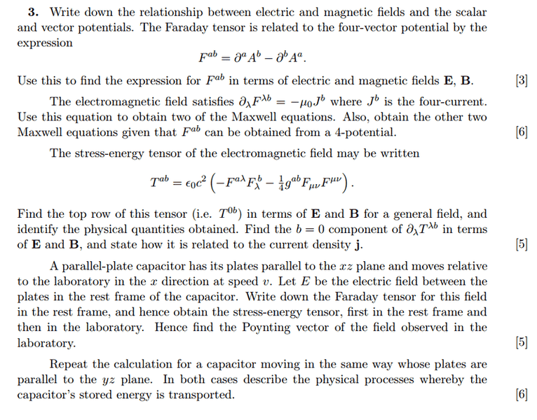

(a) Find faraday tensor in terms of ##\vec E## and ## \vec B ##.
(b) Obtain two of maxwell equations using the field relation. Obtain the other two maxwell equations using 4-potentials.
(c) Find top row of stress-energy tensor. Show how the b=0 component relates to j.
Part (a)
[/B]
The relations between the potentials and fields are:
[tex] \vec B = \nabla \times \vec A [/tex]
[tex]\vec E = -\nabla \phi - \frac{\partial \vec A}{\partial t} [/tex]
The four-vector potential is given by ## A = \left( \frac{\phi}{c}, \vec A \right)##.
From the relation given: ## F^{ab} = \partial^{a} A ^b - \partial^b A^a ##, it looks something like ##\nabla \times A##. How do I show this? I've read the basics of tensor notation and seems alright, but I can't seem to apply the knowledge.

Just start writing it out explicitly. For example, what do you get for ## F^{01}##?

[tex]F^{01} = \frac{\partial A_x}{\partial \phi} - \frac{1}{c} \frac{\partial \phi}{\partial A_x} [/tex]
I don't see the point of writing out everything, as it only gives terms like ##A_x, A_y, A_z## and partial derivatives..
You're not calculating the correct derivatives. What does [itex] \partial^{a}[/itex] stand for?

##\partial^a## is a compact notation for a derivative with respect to a space or time coordinate: ##\frac{\partial}{\partial x^a}##

The notation ##\partial^a## means it's a derivative with respect to space-time coordinates. It has nothing to do with the 4-vector potential. It has to do with the space-time coordinates ##(t,\vec{x})##. Specifically ##\partial^a=\eta^{ab}\partial_b\equiv\eta^{ab}\frac{\partial}{\partial x^b}=\eta^{at}\frac{\partial}{\partial t}+\eta^{ax}\frac{\partial}{\partial x}+...##

Why are you taking the derivative of ##t## in the second term? Also, your factors of ##c## look off to me. Maybe write it out in index notation first if you are still getting confused. You're almost there though.

[tex]F^{01} = \partial^0 A^1 - \partial^1 A^0 [/tex]
The space-time four-vector is ## (ct, \vec r)##. The four-vector potential is given by ## (\frac{\phi}{c}, \vec A)##.
[tex]F^{01} = \frac{\partial A_x}{\partial ct} - \frac{\partial \frac{\phi}{c}}{\partial x} [/tex]
[tex] F^{01} = \frac{1}{c}\frac{\partial A_x}{\partial t} - \frac{1}{c}\frac{\partial \phi}{\partial x} [/tex]

Ok. I think all that's left is you are missing a negative sign that should have came in when you raised the indices in ##\partial^a=\eta^{ab}\partial_b##. See post #8 above. Depending on what metric signature you are using, one or the other term should have an additional negative in it.
After that, ask yourself "what is ##E^x##?"

[tex] \vec E = -\nabla \phi - \frac{\partial \vec A}{\partial t} [/tex]
[tex]E_x = -\frac{\partial \phi}{\partial x} - \frac{\partial A_x}{\partial t} [/tex]
[tex]F^{01} = \frac{1}{c}\frac{\partial A_x}{\partial t} - \frac{1}{c}\frac{\partial \phi}{\partial x} [/tex]
As matterwave has pointed out, I was wrong when I said in post #8 that ##\partial^a = \frac{\partial}{\partial x^a}##. I should have said ##\partial_a = \frac{\partial}{\partial x^a}## with the index in the lower position on the left side of the equation. Matterwave has shown how to relate ##\partial_a## and ##\partial^a##. Sorry for the confusion.

[tex]E_x = -\frac{\partial \phi}{\partial x} - \frac{\partial A_x}{\partial t}[/tex]
[tex]F^{01} = - \frac{1}{c}\frac{\partial \phi}{\partial x} -\frac{1}{c}\frac{\partial A_x}{\partial t} [/tex]
This implies that ##F^{01} = \frac{E_x}{c} ##.

Ok, now do this for ##F^{02},~F^{03},~F^{12},...## and you will have your answer. Notice that ##F^{ab}## should have 6 independent components because it is anti-symmetric, so only the top right (or bottom left) triangle is independent. Be careful with the negative signs though.

[tex]F^{01} = -\frac{1}{c}\frac{\partial A_x}{\partial t} - \frac{1}{c}\frac{\partial \phi}{\partial x}[/tex]
[tex]F^{02} = -\frac{1}{c}\frac{\partial A_y}{\partial t} - \frac{1}{c}\frac{\partial \phi}{\partial y}[/tex]
[tex]F^{03} = -\frac{1}{c}\frac{\partial A_z}{\partial t} - \frac{1}{c}\frac{\partial \phi}{\partial z}[/tex]
[tex]F^{12} = \frac{\partial A_y}{\partial x} - \frac{A_x}{\partial y} [/tex]

Like I said, be careful with the negative signs. Why do you have a negative sign in the first term here?
There's 2 other components of ##F^{ab}## that matters. Now match these expressions to ##\vec{E},\vec{B}##.

By inspection, the time-like part is electric in nature, while the space-like part is magnetic in nature?
[tex]F = ( \frac{1}{c}\vec E, \vec B) [/tex]

The statement is correct, but this mathematical notation doesn't really mean anything...

You can either simply enumerate ##F^{01}=E^x, F^{02}=E^y,...## or, usually for simplicity, you can write out a 4x4 matrix and then put in the corresponding ##\vec{E},\vec{B}## components.

I think writing out the 4x4 matrix is simpler and better, since this is the presentation adopted in the text as well.
I'll have a go at parts (b), (c) and (d) meanwhile!
