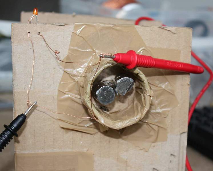

The problem is with the generator, but for the life of me can't figure out what's wrong. I've tested all the variables as far as I can tell, read everything I could find online, watched all the videos of people building their own generators. What is so obviously wrong?
Thanks for any help, please see photos attached for generator set up.
Tom
Tom
See my first comment. You need to generate DC. Unless you have a diode or a commutator in that generator, you will generate AC. What you have is an alternator. This will charge the capacitor in the first half turn and then discharge it (ie apply opposite voltage) on the other half turn. The simplest solution would be to put a diode in series with the output of the generator.

I can't tell from your pictures but I believe your biggest problem is with the magnets. It looks like you have two round magnets side by side turning within your coil. This is fine if the magnetic poles are perpendicular to the coil. Looking at your pictures, it looks like the magnetic poles are parallel to your coil. If I'm right you will not get enough voltage to make it through the bridge rectifier to charge the capacitor. Because you are using magnets, the magnetic field doesn't collapse and expand as it does in transformers. This makes pole orientation a critical design consideration. As stated before test this circuit in steps. Connect your generator to a voltmeter and measure your voltage. Then change your magnet orientation so the flats of the magnets are perpendicular to your coils. Measure the voltage out again. If you see a huge difference, you found your problem.
Once you solve this try to center tap your coil. Make the tap your negative terminal and the ends will have diodes with their anodes connected together to give you the positive terminal. This way you get full wave rectification with only .7 voltage drop. Good luck.
