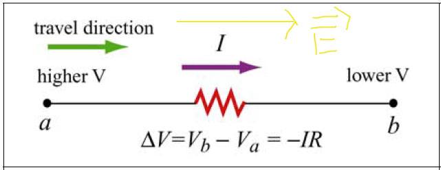

I am trying to compare the "relation" conventions used in Kirchoff's Loop Rule with Faraday's Loop Rule.
Kirchoff
Please go to this MIT OCW link on Kirchoff's Rule and go to page 8/29. Of the four boxes, I would like to point this one
Note that the yellow electric field was added by me. This picture also follows the integral
[tex]-\int_{a}^{b} \mathbf{E}\cdot d\mathbf{s} = \int_{a}^{b} -Eds = \Delta V = \varepsilon = -IR [/tex]
Since ds and E are parallel.

Now I go through the resistor, so I get +IR, since E and dl are in the same direction, Ohm's Law tells me I get +IR
Note that his circuit arrangement is exactly like mine, he went from a high potential to a low potential. The current, electric field in the wire, and the traveling direction are all the same, yet he gets +IR instead of -IR
is he still using this "E dot dl" [tex]-\int_{a}^{b} \mathbf{E}\cdot d\mathbf{s}= \Delta V[/tex]? How does Faraday's Law apply for non-closed paths? Because it seems like Lewin is using [tex]\int_{a}^{b} \mathbf{E}\cdot d\mathbf{s}= \Delta V[/tex] (no minus sign)
The same confusion goes when he talks about the electric field in the battery.
Could someone please clarify for me? Thank you
